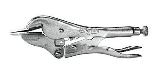

    Irwin 23EL5 Vise Grip Sheet Metal Tool

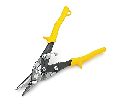

    Wiss M3R MetalMaster 3/4-Inch Snip
