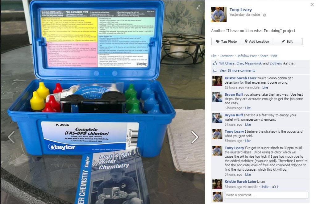

    Ok, I got the K2006 Thursday and just got around to doing the chlorine test. I got 1.2ppm free chlorine and 0 combined (I think anyway). I did a 25ml sample in an area out of the flow of water at 18" deep. 2 scoops of the powder turned it a dark pink and 6 drops made it clear. 5 drops of the other and it was still clear.
    Looking at Table B will tell me how much chlorine to add for 30ppm to kill the algae based on %available chlorine and volume of pool, however, I'm not sure how to calculate %available. I'll be using Aqua Chem's Shock PLUS (Sodium dichloro-s-triazinetrione 58.2%) - 1LB.
    I haven't gotten around to calling WaterAce yet as they have the same work hours as me but I'll get to it this week. Meanwhile, if I keep the filter cartridge sprayed off, the pressure is between 5-20 and plenty of circulation around the pool for about 48 hours.
    btw, I was joking around on Facebook about buying this kit, and my cousin Bryan (who I went to first for help before here because he has "been in the biz for 20 years") made these comments (image below). He didn't reply to my initial call for help so I tried to sound smart just to troll him...
