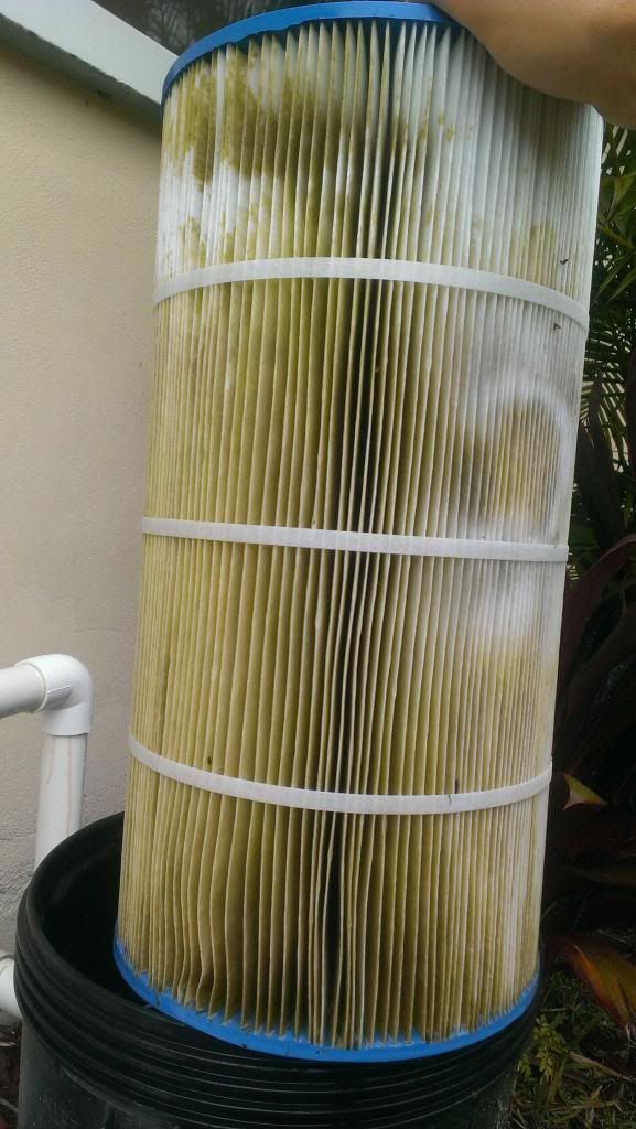

    Well it hasn't been quite a month yet but I'm getting algae growth again. It's been raining for 40 days and 40 nights it feels like. Right now my FC is 3.0 and CC is 0. I just opened the housing to see the filter since I last posted and the image below is what I found.
    The psi is still at 4.

    If you are getting algae, then it is because you are letting your chlorine get too low. How often are you testing the water? Run a set of tests with your K-2006 and post them along with your volume. What are the ingredients in the shock plus?
