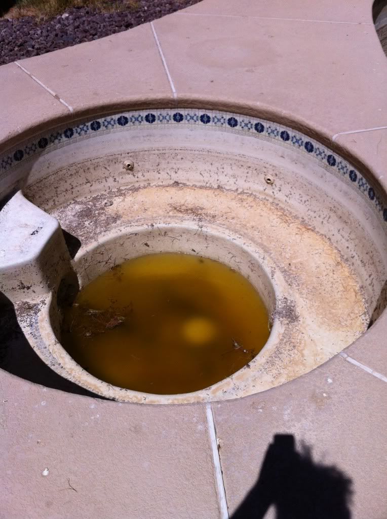

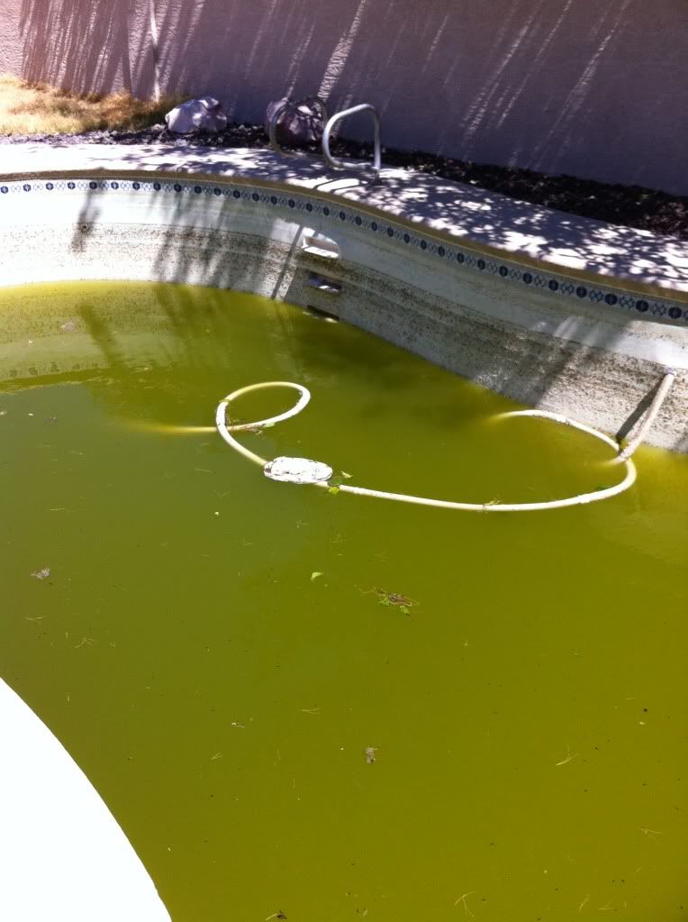

    When I first looked at the house in Feb the pool was immaculate. It was a short sale which means it took until now (4 months later) to actually get the house. Althought they were supposed to keep the pool maintained it hasn't been touched since then, so the water level has dropped some 4 feet and the water is so green you cannot see the bottom even at the shallow end. The exposed sides are covered with baked on debris under the hot Nevada sun. We can't even see if the pool light is working because of the gunk. Going to post photobucket pic links, not sure if I have the right privileges yet.
    So, other than calling in an airstrike and starting over, what plan of attack can you recommend? Since I need to eventually learn how to maintain a pool, I'd like to try this myself rather than call a pool service, at least for now.

    Can you say YUCK!! We can help you clear the water up but the biggest concern is the fact that it has lost 4 feet of water since February. That is a lot of water. There must be a pretty significant leak somewhere.
    Go ahead and give us some information about the pool by filling in our pool chart and then someone can help you go from there.

    We typically do not suggest totally draining a pool. Also, acid washing is a last resort because it removes a layer of your finish and makes a pool more likely to stain.

    Watermom's right, but since you are in the desert, draining shouldn't be too much of an issue.
    However, if they were supposed to maintain the pool, I'd think it's worth a phone call to see if they can be prevailed upon to clean the mess up. Otherwise I'd plan to spend some personal time with a pressure washer!

    Thought I'd let you guys know that my realtor came to the rescue by finding someone to put to pool back into pristine condition for $400, with each of us contributing $100 (me, seller, and the 2 realtors). Although I shouldn't have had to pay anything it's better than being stuck with the entire cost. They drained, acid washed, chlorine washed (hadn't heard of that before), refilled, and added whatever chemicals were needed. They even cleaned the automatic bottom crawler/cleaner thingy (whatever it's called) as it and the hose were green from the algae. They checked out all the equipment to make sure everything was running properly and set the pump timer. Guess they've had a lot of experience with all the green pools at all the foreclosed houses here.
    I haven't seen it yet but the realtor was very impressed with their work. Says it looks brand new and was thinking about getting them to do his own pool, not that it needs all that went into mine.

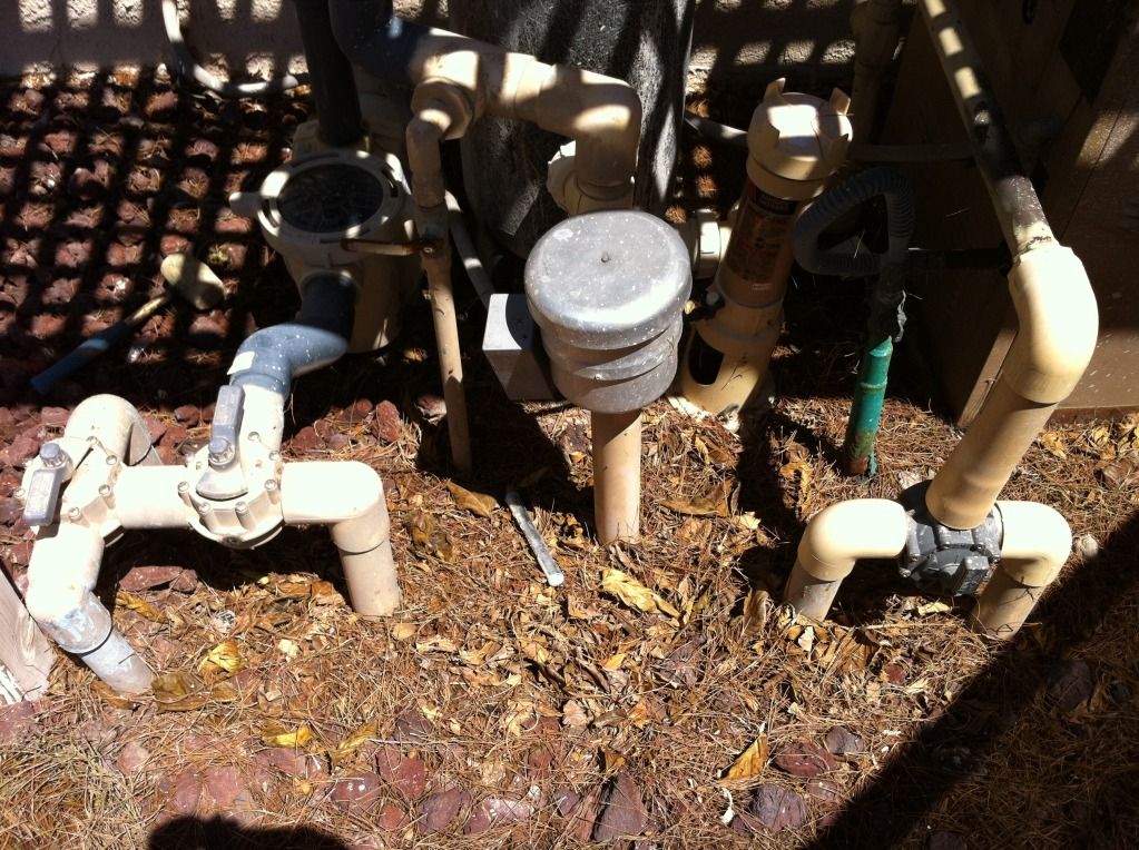

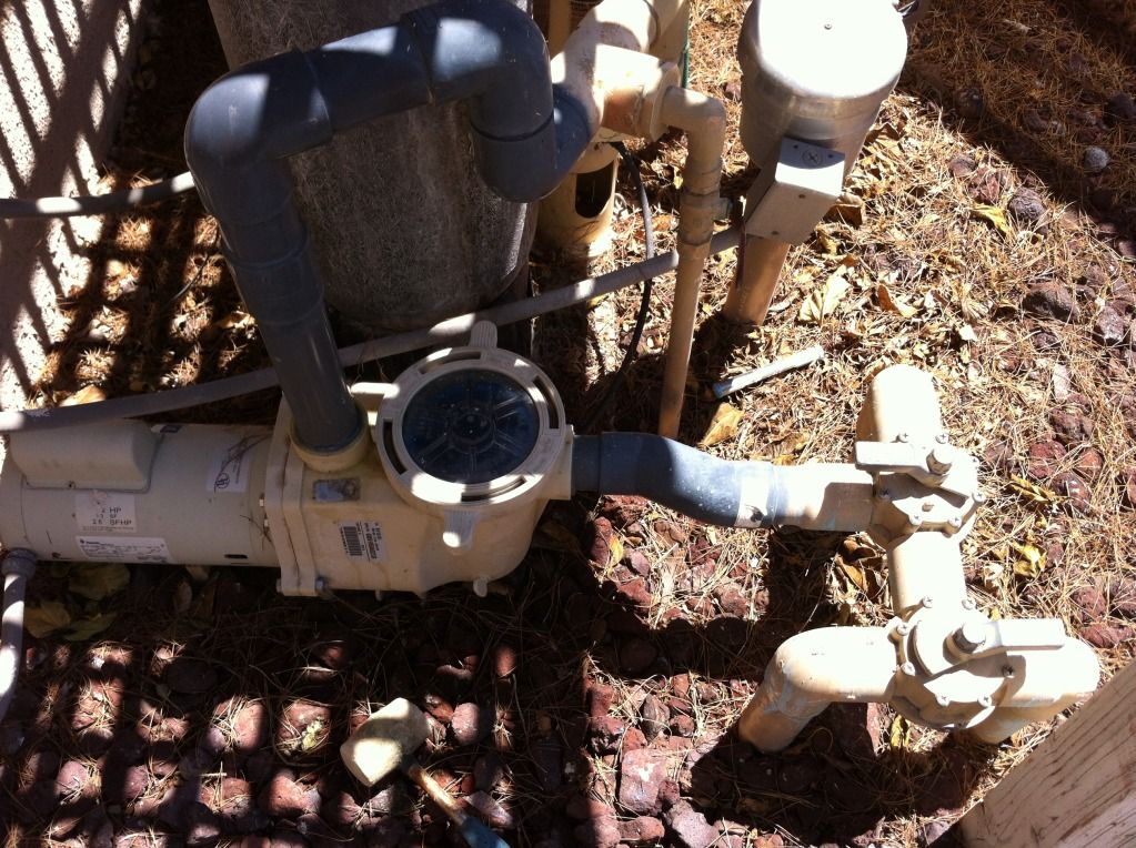

    Still waiting to close on this house, but in the meantime, can anyone give me a primer on using the valves shown? There are 3 inlets going into the pump, obviously main drain, skimmer, and jacuzzi drain, with 2 open/close valves.
    Then coming out of the pump and before going into the filter there is a T joint, with a small pipe going into the ground. This pipe has a small open/close valve between the T and the ground. Don't have a clue what it's for or where it's going. My best guess is it's to drain the pool.
    There's one valve-less pipe from the outlet of the filter, into the water heater. Then out of the heater to a pair of pipes back into the ground. One to the jacuzzi and the other to the pool I assume. (2nd pic)
    There's also a cylinder sticking up out of the ground by the heater labeled Bromine. No obvious way to tell how it's connected underground. It's to the left of the green gas pipe in the 2nd pic.
    There's no obvious way to do a backflush that neither me nor my realtor (who also has a pool) can figure out. Or does this kind of system not need one?
    We found the jacuzzi water-jet switch, but it makes a screeching sound like a bearing is shot. The sound is coming from within the heater housing.
