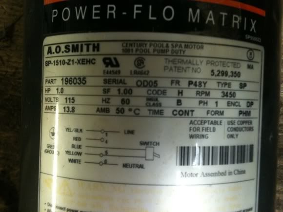

    Possibly, there may be some repairs that can be done. Send in the model number & make of the MOTOR (not the whole pump) and if possible, some pics of the motor, motor label and motor end housing, and we'll see if we can work it out.

    Hope this helps. Let me know if you still want the motor end housing pics too.

    What's the rating of the breaker? 13.8 is pretty close to 15. How far from the panel? Cord Length? Wire guage? I'd guess that if it's a 15 Amp breaker and the breaker is pretty far from the outlet (wire length) with 14 ga wire and an extension cord and a couple lights - you could be drawing more than 15 Amps. Or, maybe not.

    If you have access to a clamp-on ampmeter then measure the actual current the motor draws. The current will change with motor loading. That along with the voltage at the motor like Ben suggested will tell you the true facts of your pumps operation. You are near the breakers trip point, according to the motor plate, and that's not so good.
