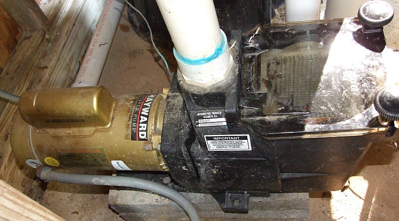

    I'm getting about 80 gpm. I'll never get to the 244 gpm required to turn my pool in 6 hours. I would, however, like to improve upon the 80 gpm.
    88,000 gallons, two 500 lb sand filters, 2 hp and 1.5 hp pump. Two 3 inch pipes return from the skimmers and bottom (1 pipe for each). Pipes drop to 1.5 inch before each pump. Each pump feeds a filter (1.5 inch pipes) and then the pipes combine again in a 3 inch junction.
    Each 1.5 inch pipe should theoretically give me 74 gpm. Filters are rated for "up to" 98 gpm. I should theoretically be able to achieve 140 without changing pipes or filters (I think).
    Before I spend the money, I am trying to figure out if larger motors on my pumps will give me extra flow. Are my assumptions above incorrect? Any thoughts?

    To answer your question, it's necessary to actually do some hydraulic calculations, AND to know and consider the pump curves of your two pumps.
    But, I'm puzzled by your reference to 244 GPM being "required". As far as I know, there are no requirements of flow on residential pools.
    Why? Most pools do fine with 1 to 2 turnovers per day unless this is a public pool.
    [EDIT: As noted above, it IS a public pool. Very different rules apply! PoolDoc. ]
    Also, if 80 GPM is the combined flow rate, that would be very low. A 1.5 HP AND a 2 HP in parallel should produce well over 180 GPM on low head loss plumbing. Why do you believe the flow rate is so low?
    There are no theoretical limits to flow rates in pipes, only recomendations. Water can travel as fast as the pump can deliver.
    What are the two pump model #'s and both filter pressures?
    How far is it from the equipment to the pool?

    LOL. Inherited responsibility for neighborhood non-profit. 3 feet at one end, 10 feet at other.
    County requirement for turnover is 6 hours. Pitot flow meter shows 80. Not sure if it has enough horizontal length to be accurate, but if it's anywhere close, we have low flow.
    Pumps are 1.5 to 2 feet above water and about 8-12 feet from water's edge on the shallow end. I'll have to go by tomorrow and look up the models. I was up there tonight putting a snake in the skimmers. 4 of them and only 1 has decent flow. Baskets float up. Didn't find any blockage (yet).
    One pump doesn't have bubbles, one has small ones. I don't see any bubbles in the water coming out from the returns.
    Filter pressure (on top) is 10-12 psi. Goes up to about 15-20 after 1-2 weeks without backwashing. I put the pumps on recirculate and don't see any improvement.

    I do have air in at least one pump. I couldn't see it coming out of the returns until I jumped in the pool and held my hand to them. Tiny, tiny bubbles.
    I did find some trash in the 2 HP impeller. I get about 90 GPM now with both pumps on. Made sure both drain plugs were tight.
    I put a 25 foot snake in the skimmers, nothing. Put it in the skimmer return via the pump, no issues that I could find.
    The farthest skimmer still barely has any suction and the basket just floats.....

    Here they are:
    Pump room
    Multiport label
    Piping
    Pump #1
    Pump #1 label
    Pump #2
    Pump #2 label
