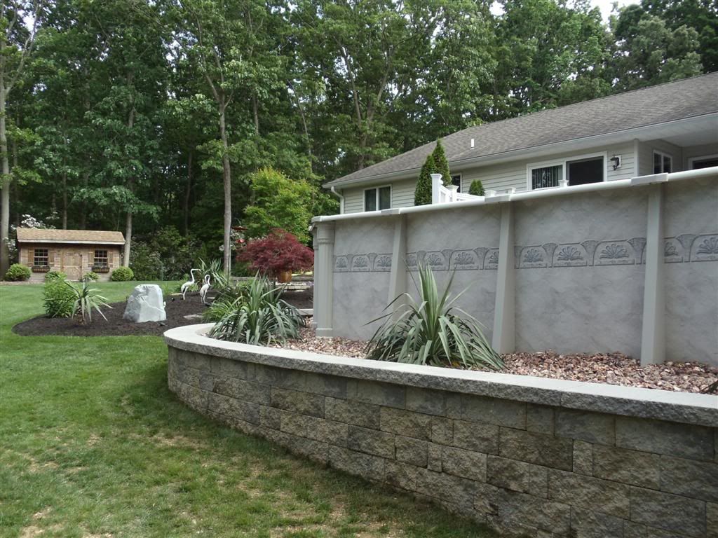

    Here is our pool with a retaing wall and rocks around it.
    [/IMG][/IMG]

    Default Re: How would you backfill this (picture included)
    Let me try this again
    [IMG][/IMG]

    Awesome! and cool yard too!
