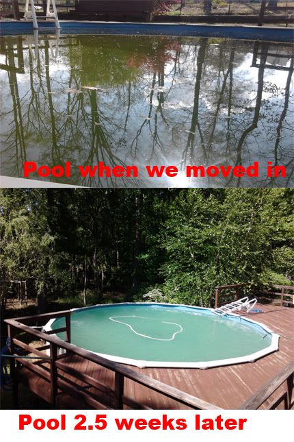

    HOLY WOW!!!!!!! that is the exact color my pool was when we moved in 2 weeks ago! I should go take a picture and do that everyday to show the progress. It got to where it was a light sea green, but for some reason, after I added everything, it's back to a nasty green.

    Ok, sorry I haven't updated, been crazy. My free chlorine level has been at the 20 mark now since yesterday. And it even rained real good yesterday. My PH is dropping to the low low mark. So I guess I need to add more Borax? It's looking a little better. Still green but getting better. Am I still doing everything right? I've been doing what y'all have said...except I've stopped adding bleach cuz it go so high. Is that right. Here's a before and now pic of my pool

    1. Yes, add borax, if your pH shows low. But, you might want to set some pool water out in a shallow glass bowl, in the sun, and test the pH at the end of the day. Hopefully, the chlorine will be low enough to get a valid pH reading. Worst case: adding too much borax won't hurt much.
    2. Be sure to brush the pool carefully. You don't want to leave any undisturbed piles of algae. Free chlorine does NOT penetrate 'algae clumps' well.
    3. Do what you can to help your filter. Or, consider filling to overflow, turning your pump off overnight, and vacuuming to waste (via siphon) in the AM -- to get the settled algae out.
