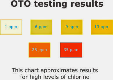

With your OTO kit, if your chlorine is over 5ppm, you can use this chart to interpret off the scale colors:> http://pool9.net/oto-chart/
Your pH will be inaccurate if your chlorine is over 5ppm (or over 10ppm with the Taylor kit). So, if you have high chlorine, you can dilute your test sample 50/50 with pool water and distilled water and then test pH with that mixture.
