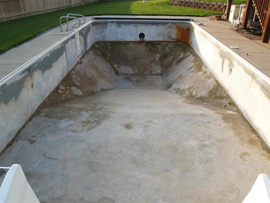

    I'm replacing my 11 year old 18x36 IG liner. After getting the old one out, I have several issues that I need advice on.

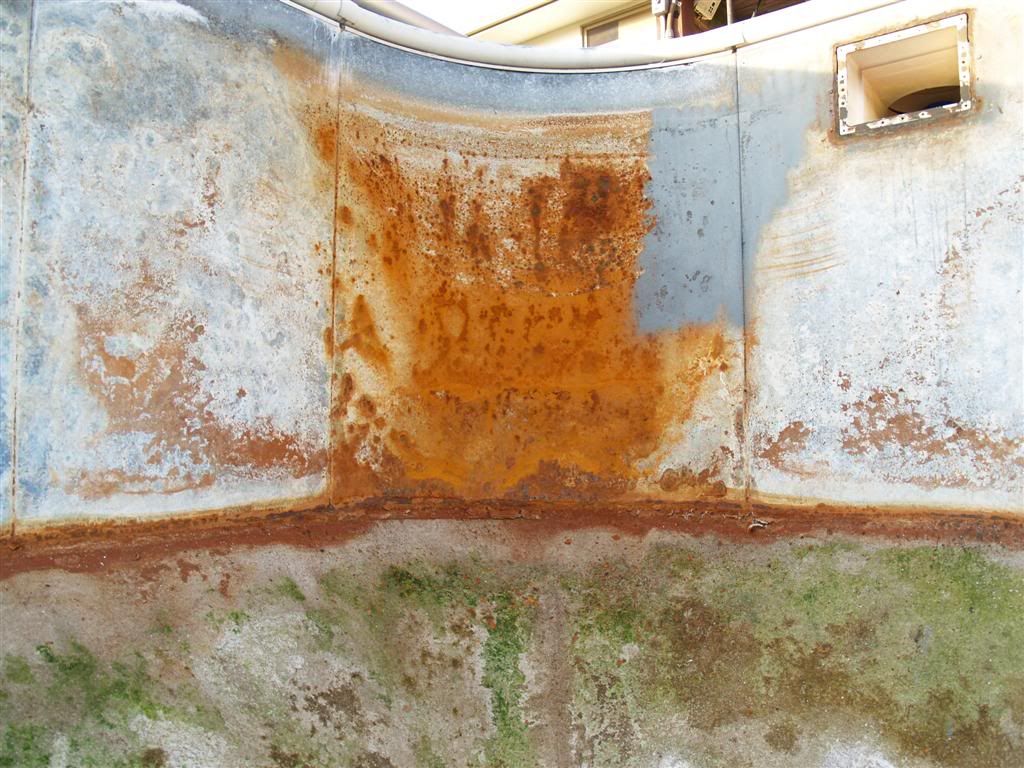

    1. The galvanized walls have rust in several spots where the liner had leaks. The contractor recommends grinding the rust off, priming, and then covering with 3M wall foam. Seems like a foam would hold moisture next to the steel, not protect it, but I'm not a pool guy. I would use something like POR15 like I've used on cars, but again, I'm not a pool guy. I trust my contractor, but I'd like confirmation from the experts (waste, etc). thoughts?

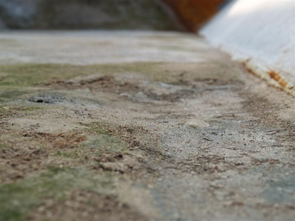

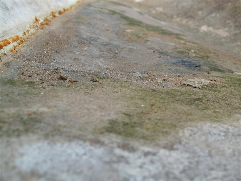

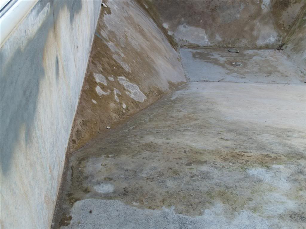

    2. The vermiculite bottom is rough and needs help. He recommends removing any bad spots and a "skim coat" over the whole bottom. Cost is around $1200 --- seems high, but it also looks like a lot of work.
    3. Lastly, I need a new light as the one in the pool currently has no extra cord or wire (the current light has absolutely no extra wire, it will barely come out of the housing). He recommends a new light/cord combo with enough cord to get it up on the deck for future bulb replacements.

    I'm curious: Did he do the vermiculite in the first place? If so, why is it breaking down? Could you get a simple sand floor over it?
    I cannot answer the corrosion question but it must be cleared up. If the foam doesn't trap water against the wall I don't see a problem.

    When I had my liner replaced a couple of summers ago, I, too, had some rust. (My pool is above ground.) The guy sanded it off and sprayed it with something like rustoleum?? Not sure, but I *think* that is what it was. Al (Poconos) has seen my pool and has banged on the sides where the rust was and he thinks it is fine for awhile yet. I'll probably try and get a few more years out of it, but I'll certainly not wait til it HAS to be replaced before I do so. I don't need 13,000 gallons of water running towards my house!!

    CarlD - I'm not sure if he did the vermiculate originally or not. I doubt it. We aren't the original owners. I suspect the vermiculite is broken down from the leaks and the abuse of thousands of crashes into the bottom of the pool by the kids. I'm not really sure though.
    Watermom -- they started out spraying Rustoleum cold galvanizing compound, but they think a few areas need more than that, thus the need for foam.

    Ridding the walls of rust and preventing it's spread/ reoccurrence is a good and wholesome thing. I'm not a car guy, so can't compare the products I would certainly use wall foam to protect the liner, UNLESS you have a high water table!
    If they are charging ~ $1200 - you must have some large areas that need, not just the skimcoat, but the full 2" applied. I'm starting to suspect ground water issues in your backyard.

    I checked out the vermiculite this evening and it is soft in a few places....almost spongy. Is that caused by a couple of years of leaking liner? Parts are green.
    I'll post pictures if I can.
