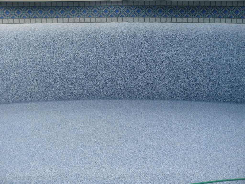

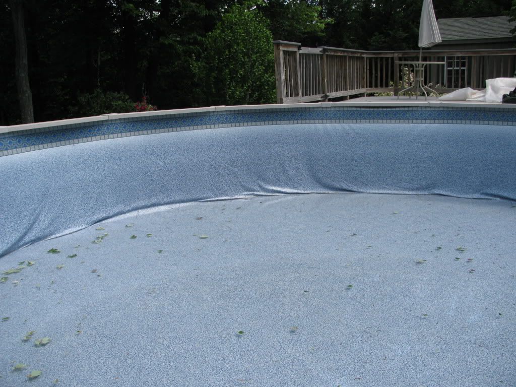

Hi. I have a Johnny Weismuller pool, 24' x 52" tall round, about 6 years old and have to replace the liner due to the ice damage this past winter.
My last liner had a few wrinkles that always annoyed me.
I have installed the new one, with one inch of water in it so far, and it seems to have even more loose material than the last one. I worked the wrinkles towards the sides. I am worried that when the pool is filled, the bead won't stay in the track and there will be an excess of vinyl along the top.
My question is, should I start over and remove some sand from the bottom?
I always felt that was my mistake in the original installation. Here's a photo:
You also might want to lessen the cove at the bottom of the liner.
