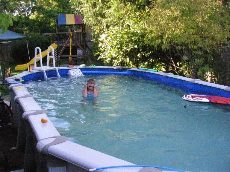

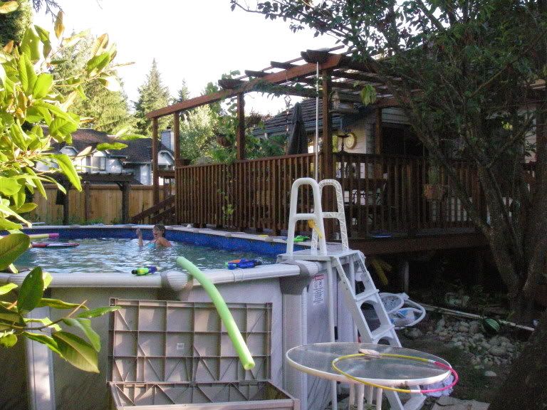

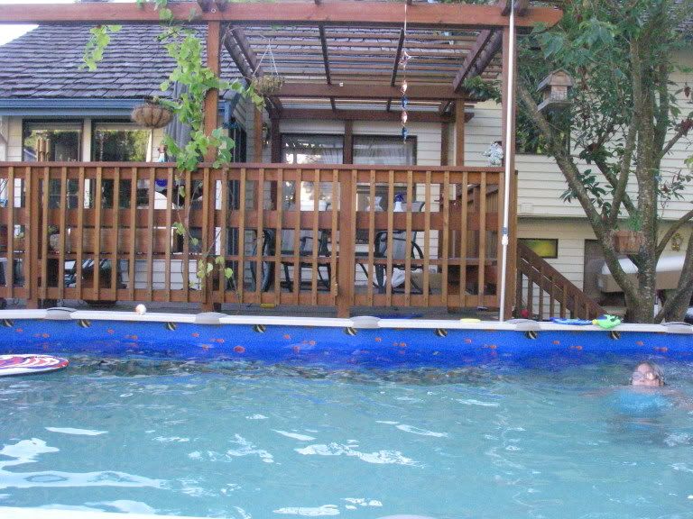

    Alright nwmnmom, you asked nicely for pictures and were very patient... so here you go...
    Next mission: Get hardware to install solar panels so kids can stop playing "Penguins and icebergs"... but that will be a separate thread .
