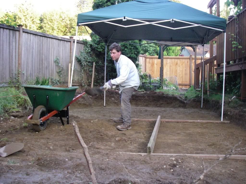

    This week I've started manually digging my ~8" grade to get it down to <1/4" level.

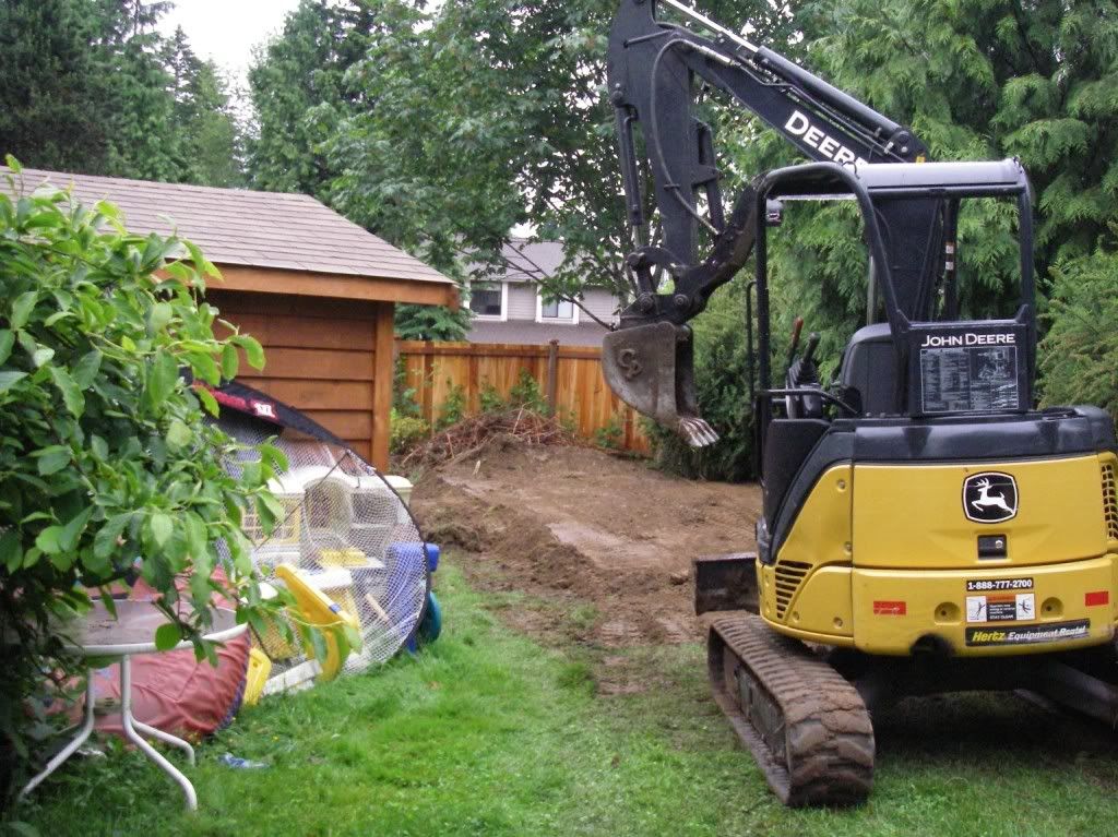

    This Saturday we've lined up 1 day rental of a mini-excavator (M 310) from Hertz for about $500 including tax and round-trip delivery. That ought to make digging much easier and much more fun! I could do it by hand but I estimate it would take me 5 hours of hard digging. This is supposed to be a fun project (and I'm still saving money going DIY).

    + Yard site is level to ~8". I'm fixing that to <.25" with lasers, levels, and power tools (per above).
    + Praying for sunny weather this weekend. Light showers might be involved so I've been tarping and digging when not at work this week. Overall not bad (ground >.25" is dry).

    FYI: Confirmed excavator will be John Deere D35 with 18" or 24" bucket. There is option to get bigger "cleanup bucket" ~35" but I want to make sure I can dig. The rental rep said I can attach angle iron (or other long flat bar) to the excavator's thumb then drag it to level out the site once material is removed. I'll need to get the angle iron though. (I'll probably just do that Saturday ~noon as a break-time project once I get a chance to see how it will work.)
