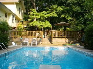

    This is my first pool and I love it. It is a 22,000 gallon inground vinyl and it is crystal clear. The owner left me enough chemicals to last the summer for sure. I just tested the water with a kit the previous owner left behind and got theses numbers. Is this in the ball park of where they should be. I am trying to aviod going to Leslies even though there is a cute girl that works there.

    Hi Mike, and welcome to the forum. Your pool looks great and you've come to the right place to be able to keep it that way. We are going to need some more numbers to be able to steer you correctly. We need to know the following numbers which your kit may not be able to give you. If that is the case, it is important that you buy a kit that will so that you can do your own testing and not get suckered into buying a bunch of stuff you don't need.
