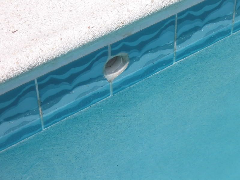

    I have a 28x14 IG pool and above the water/tile line is an outlet appx 2.5" round with threads on the inside of it, i have lived here for 3 years and the outlet has never been in use from when i had a pool service or for the past 2 years while i have been maintaining the pool myself, my question is what could the outlet be? i will be posting a picture of the outlet in the next 2-3hours so you can get a better idea of what it looks like, i hope this is the right section for this question, thanks for any help.

    Is it possible that outlet is a pipe running back to your pump that you are currently not using? Wouldn't it be nice if that pipe was connected to the suction side of your pump and you could hook the barracuda up at the outlet?

    Ha! that would be ideal, i had an idea could it be a pipe that just leads to the dirt outside the pool area in case the water level gets 2 high it would just drain out water until the level is under this pipe? here are pictures of it maybe they will help? Thanks for your ideas

    That sure looks like and overflow to me like the above user mentioned. That's right at the correct height.

    Thanks its definitely an overflow pipe, i filled the pool above the pipe and watched it drain lol ... owell it was fun for a couple hours.
