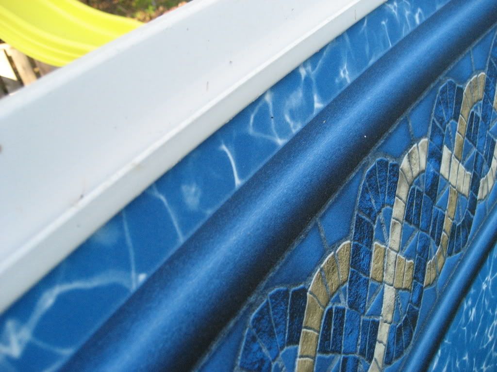

    I am confused , more than usual to day. My 15 x 24, 2 year old, Johnny W. pool needs a new liner do to a leak i can't find. I go to the shop were i bought it and order the liner they say i need. It is a beaded liner they say, and the sample confirms. They also say because it is a beaded liner, i don't need to remove the top rail to replace it.

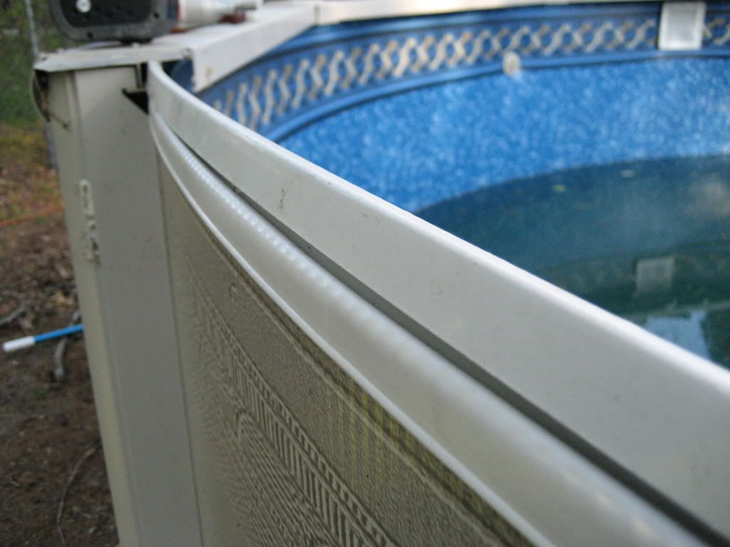

    I was just looking at the pool and pulled one of the top rails off, and i don't see how the original liner could be replaced without removing the top rails.

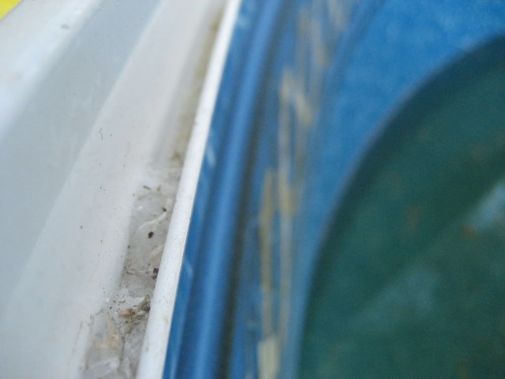

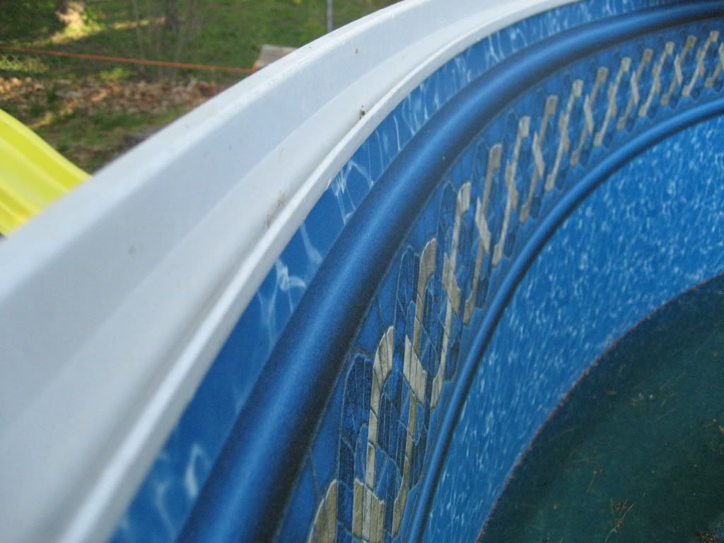

    The orig liner has a distinct white area on the very top, with a 1/2" piece that is overlapping the pool wall, this is held on by a channel that goes over the liner and pool wall, basically clamping the liner to the wall.
    Can anyone explain the differences in liner or how i can find out what i have.

    I just found the installation manual for the pool. They call the piece i call a "channel" a "bead receiver." The bead receiver has a channel on the inside that looks like the letter "J" the manual shows the 1/2" white area that is folded over my wall, in the channel of the bead receiver.
    Could it go in either spot? Now I'm really confused.

    Hi, it sounds like they had a v-bead liner in the pool. That one goes over the wall. A beaded liner hooks into the reciever on the inside of the pool. I have seen uni bead liners with both types beads so you can choose. If the liner is baggy and oversized, and you have access to take your top rails off, you can always covert to overlap if you need to. You would just need coping strips.
    The easiest I think would be to use the beaded liner in the bead reciever without taking the pool apart. The old liner can be removed with a razorblade up to just under the reciever.

    Is there no way a beaded liner could be installed overlapping the pool wall and held on with the bead receiver? I talked to the pool store this morning, they insist i got a beaded liner and are selling me a beaded liner for replacement.
    I could take some pics if that would help clear it up a bit.

    It does sound like they installed a beaded liner as an overlap.
    Does the liner have a harder plastic portion welded to it that looks like it would fit into the piece currently clamped over it pinching it down?

    There is a harder white strip, about 1/2", at the very top of the liner, that is what is where it folds over the wall and secured by the receiver. From what i see, where it would hang from the receiver, they bottom of the "J" is pretty wide, so i don't see how it could stay in there very well, but i could see it going in there

    Pics would really help!
    I have a J mold liner, the way that works is that a heavier gauge white vinyl upside down J or V is welded to the liner, it overhangs the top of the wall, a groove in my top channel (resin) fits over that to help hold it in place.
    A beaded liner would actually have a bead that clips into the receiver, I believe the bead is a harder milk jug type plastic and has burred edges to keep it in place, it just clips into to the C shaped receiver that is hung from the top edge of the wall.
    Sounds to me like you got a J mold liner and they used the beaded liner receivers as clips to hold the J on.

    If the pool store allready ordered a liner and you're pretty determined to just replace it, the beaded liner should match your existing bead receiver

    I think BK has the same liner as you Matt, I have just heard it called a v bead.
    Anything else just pulled over the wall would need coping strips, and there would be more than 1/2" overhang on the outside. Since you have the bead reciever the beaded liner should work just fine. If it is to big, pull it over the wall and hold in place with coping strips and then the reciever over the coping.
