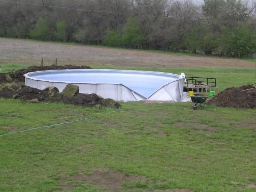

    Then all Heck broke loose.
    Here is what we have now.

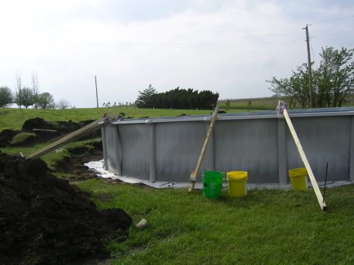

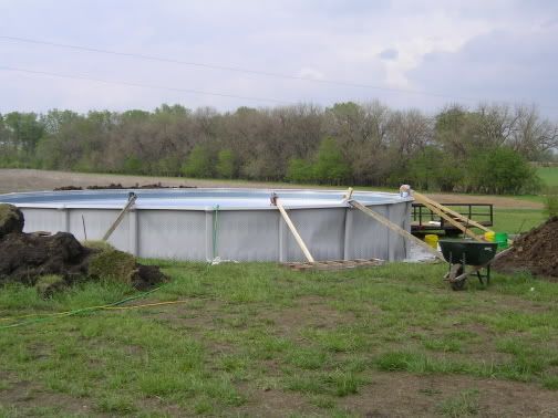

    DH braced her back up.

    Then came the big winds and she crashed in.
    Tom braced her back up and she held for the day and all night. It rained & stormed all night, there were tornadoes everywhere.

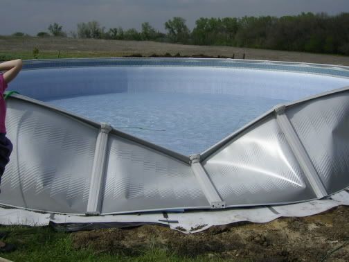

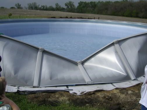

    Today it is still pouring rain. The more rain water that goes in the more the walls are buckling in & the liner is pulling the top rails in and down.
    At first the problem only seemed to be there on the south side where she crashed in ( also were the prevailing winds we blowing at the pool), But now all around the whole pool the walls are buckling.
    If you look under the Top Seats you can see some of the Top Rails twisted inside the Top Plates.

    Tom said it is not the top rails that are not pulling in. It is the walls that are being pulled down & out of the top rails & in in towards the water.

    The pump in there and we got some water out. One of the wall sections that was *sucking in* just popped back out and into it's proper position.

    Your wall looks ok, no real big creases. from what I can tell, it'll all work out just fine.
