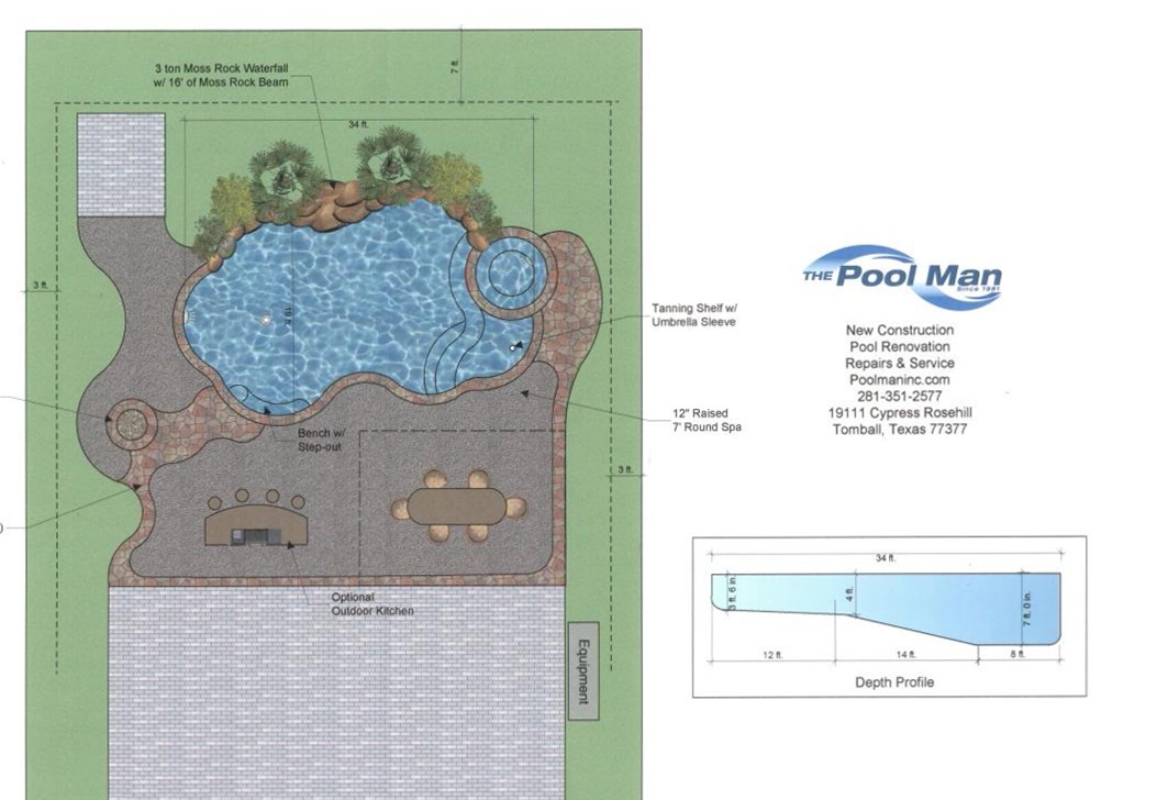

    Here is an updated design. I am going to meet with them on Saturday to make some changes. I plan on moving the spa back a bit to increase the tanning ledge. We may have to change the lines on the back wall a bit. I am also going to increase the bench size in the deep end a bit.
    Let me know what you think. Thanks!

    That looks great! Now you dont have to walk around the spa to get to your main steps/tanning ledge. Good idea putting the umbrella sleeve in your tanning shelf. Are you going to do a 7ft or 8ft spa? I will be working on our design tonight.

    It is spec'ed as a 7' but I am going to have them angle the walls back 4-6" so the spa will increase to about 7' 6". Thanks!

    Love the design. Your pool layout looks very similar to what I built last year. We love the tanning ledge and the wrap-around bench around the spa. Feel free to take a look at my build previously posted. It should give you a since of what your shallow end will look like.
    http://www.poolforum.com/pf2/showthread.php?t=5975
    My only advise is to push the spa out of the pool as far as you can. It truly does take a lot of space from your pool. Good luck on your build and keep us posted.

    I have looked at your thread in the past and you pool is great! I really like the LED lights. I talked to my PB about them and they said the effect is not so great with PebbleTec. I am planning on tweaking the design and pushing the spa out quite a bit to open up the tanning ledge quite a bit. I hope to get my approval in a week or so and then they can start. I plan on taking lots of pictures and keep posting updates here. Thanks!
