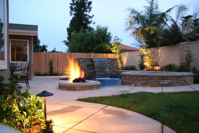

    The weather continues to be beautiful here in Huntington Beach, CA. Our pool water is 85 F without the use of our heater. As a reminder, we have a NEW (Still waiting on the Final), small pool which holds somewhere between 10 - 11,000 gallons. It is sanitized using SWCG and Del Ozone system. We also have a navigator pool sweep. The surface is Pebble Sheen, and if it matters we have a 6' of sheer descents that are on throughout the day. The water remains clear, although I noticed the other day some sort of "film" floating on top of the water. Not on the entire surface, just a small portion. Could this be from the ozone system?
    The tile is clean, rock work is clean, and we seem to have no problems. But as always, I manage to have a question or two. [IMG][/IMG]

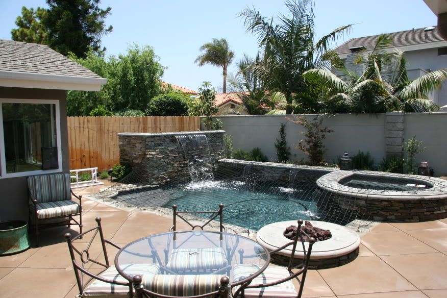

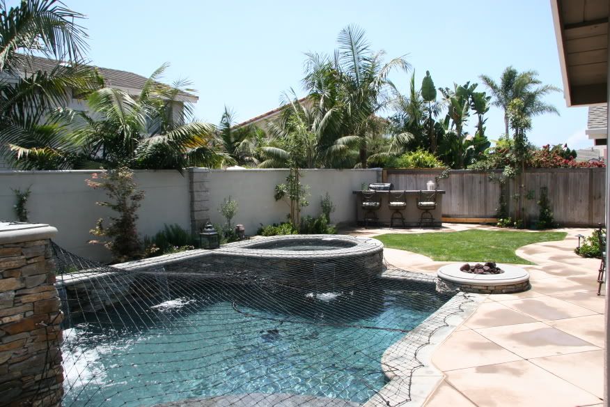

    Here are a couple of pictures of our pool!

    I noticed that you have significant waterfall features and these contribute a lot to aeration of your water. Also, you have an SWCG system and that also contributes to aeration through the tiny hydrogen gas bubbles it produces (you might only be able to see them at night if you shine a light in your pool).
    It is certainly possible that your signficant aeration is contributing to your tendency to rise in pH. Also, your pool is new and though it is Pebble Sheen, I believe that is just rock plus cement so the cement will likely be curing and this will tend to make your pH rise. Eventually, over the next months and probably stopping within 6 months to 1 year, this curing will be complete. However, the significant aeration in your pool will likely still have you fight a rise in pH.
    Check back in with this forum after 6 months or so when the curing should have slowed down signficantly and if you are still experiencing a pH rise, then we may have some more advice for you regarding lowering TA and/or using Borates for your pool (obviously check in with us before then on other issues -- we'd love to hear from you!). The low TA and borates are a couple of experiments some users are doing currently and so far appears to be very positive, but since your pool is new and still curing I would wait a bit before doing anything experimental except turning off your water features (waterfalls) and seeing if that slows down the pH rise.
    Congratulations on your new pool -- the pictures look great!
