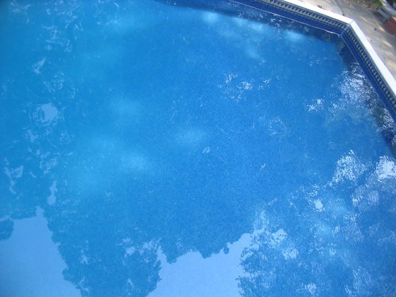

    This is the first year I've started having problems keeping the water clear. The strange thing is my test results are all in the proper ranges.

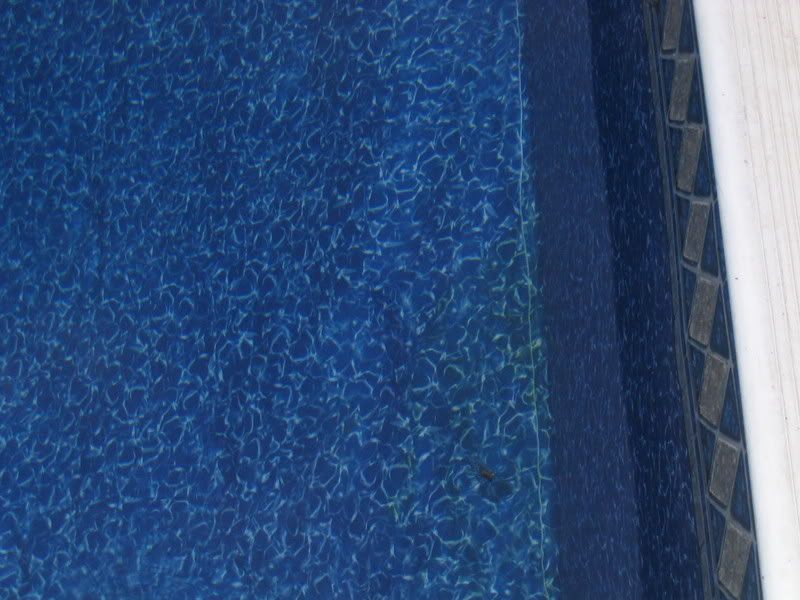

    How can my pool be cloudy and have some green on the sides when the CC reading is 0 or .5?

    Here are some pictures. The "green on side" picture is from last week. It just brushed right off. The "Cloudy" pictures are this week and after I brushed it.
    http://i32.photobucket.com/albums/d3...reenOnSide.jpg
    http://i32.photobucket.com/albums/d3...udyDeapEnd.jpg
    http://i32.photobucket.com/albums/d3...ShallowEnd.jpg

    Maybe your chlorine level dropped too low at some point and the algae began. Sometimes people will have the beginnings of something in their pool but no CC reading. Go ahead and shock the pool. Test a couple or 3x a day and each time take your chlorine back up to shock level. Also run your pump 24/7. Brush the pool, especially the parts where you see algae growing. Your water will clear up.

    Sometimes even though there is no combined chlorine you can start to have algae. It is when there is enough chlorine in the water to keep a big bloom at bay. Have you noticed that you have had to add chlorine more often? You will need to take the chlorine level up to shock, and keep it there for a couple of days to make sure all that is started is killed. With a cya of 30, you need to take the chorine up to 15ppms and leave it there being very consistant. Don't let it fall down below 15, and brush and and backwash often, keeping the filter running 24/7 till your water is clear.

    No, I'm not running SWG. I've started to shock it and it's clearing up. I didn't know why my CC was 0 and my water was cloudy. But as long as it's clearing up I'm happy. I am doing a lot of landscaping around the pool and a lot of dirt has been getting in the pool. I'm sure that's not helping.
