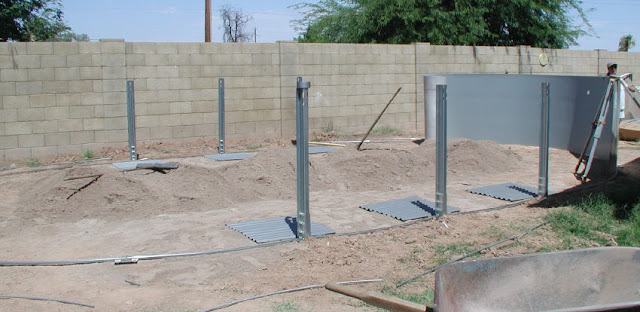

    Hi, I remembered to take my camera to work with me today. We installed an 18' x 33' Gilbralter, Cantar sold by Leslies. I started taking photos after the grass was removed and the ground completely level. The first photo shows the massive strength of the buttress free design. An extremely heavy U-channel is used for both the vertical and and horizontal brace supports. My wife had made the comment to the customer about each assembly being so heavy it took two men and an ape just to move them. As I was carrying one to the pool area I asked where my two men helpers were. They are heavy.
    The next two photos are the brace assemblies installed. I start by laying the entire brace system out on top of the ground. I then mark where the trenches will go and move everything out of the way. When the trenches are dug I set a 12" patio block in the rear. At this point I use a laser level and level the trench and the block. The brace channel measures 3". If the ground you leveled reads a 6 on the level stick the trenches and blocks should be set at a 9. When the trenches are all level the braces can be set back into place. I recheck all the all measurements to make sure the assembly is square. I then recheck the level at the front and rear of the channel. This time I measure from the top of the channel, ground level, so my number would be 6.
    The next photo shows the pool ready for sand. The end footplates have been leveled and the ground treated with grass killer.
