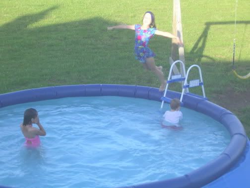

    We have 7 children. The oldest is 10yrs old.
    DH and I want to swim too, but this little puppy just doesn't cut it anymore.
    We really need something for the get togethers/swim parties.
    Maybe keeping the little Intex for the tiny kids will satisfy Dear Hubby and the urge to "modify" the big pool will vanish..... unless of course it's a testosterone thing.
    Here's what we have for all the kids now:
    Like I said... time for an upgade
    This is last summer's picture. Cloudy water courtesy of pool store logic. This year crystal clear water courtesy of BBB.
    ~Hoffmans
