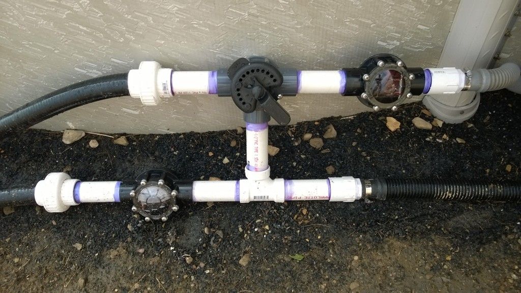

    Mas985,
    Attached are photos of my valve manifold and the solar panels.
    18' x 33' AG pool, 2HP US Motors / PMX pump with 200 # Columbia Sand Filter, (2) 4 x 20 FAFCO Solar Panels

    Default Re: Solar Panel plumbing and flow rate
    In this picture, are the panels on the left and the equipment on the right? Because the valve position would not be correct position for solar operation. You want to close off the bypass (partially or fully with handle upward). Otherwise, no water will flow through the panels.
    The panels are to the left and I have reconfigured the valve so the "off" position is vertical when all flow is going to the panels.
