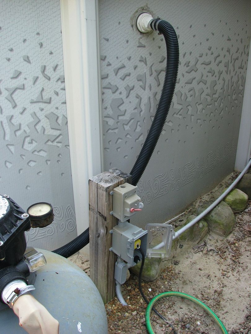

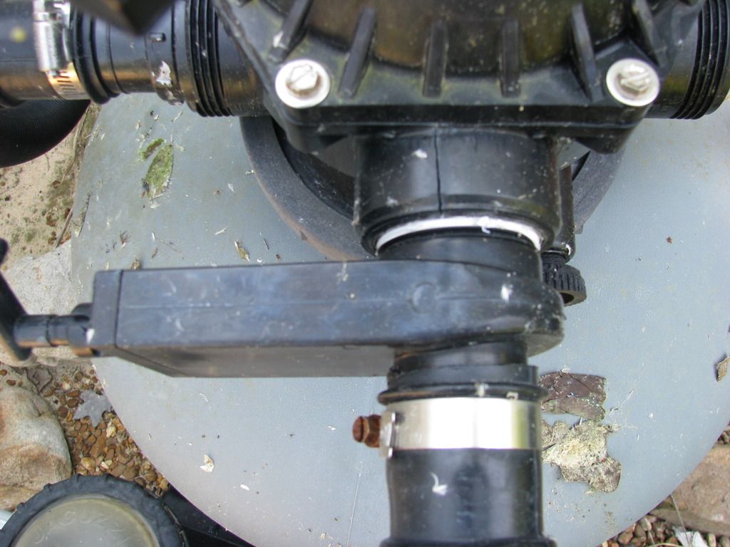

    Then, as stated in my previous posts, BIGGER is BETTER for sand filters so get the biggest one you can afford. A 2-speed pump is way more desirable than a single speed pump since your power consumption is dramatically reduced at lower RPM's. And, as I saw in your pictures, you should really consider replumbing everything you can with straight walled PVC and ditch the flex-tube connections. Straight PVC has lower head loss then lots of long flex tube runs.
