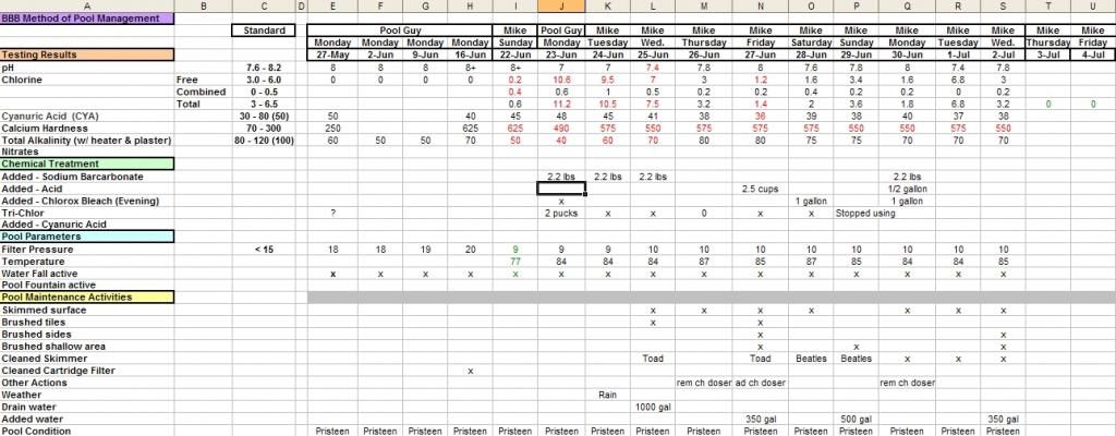

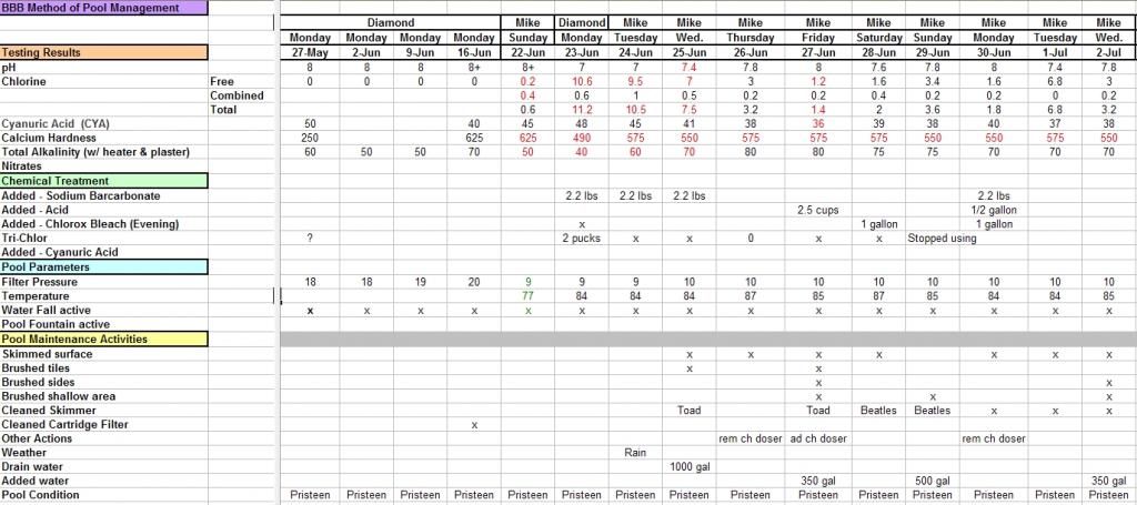

I have been doing daily testing to determine what exactly is happening to all chemical values in my pool over time to determine how my pool reacts to a normal operational mode of pump and filter on at 9 am and off at 7 pm. Kreapy Krauly on for 3 hours a day, waterfall on from spa to pool along with a general maintenance plan outlined in the following spreadsheet. Daily chemical results are also listed as well as when I added treatments to the pool.
I have been conservative in my chemical additions as I am slowly sneaking up on what I think is normal for my pool.
pH is easy to control and slowly rises over time. I believe this to be because of the water fall which oxygenates the water.
Free Chlorine falls rapidly. The pool is fully exposed to the Texas sun and probably the water fall contributes to the chlorine loss. I understand I will have to deal with this on a periodic basis and right now I am determining how much to add and at what frequency to add it to the pool. I think I probably will need to add a little more chlorine when I treat the pool to off set the rapid lowering of FC and I will be monitoring this closely for another week or so.
Total Alkalinity is relatively stable but it was low when I took over pool management. I have been adding Sodium Bicarbonate and will continue to do so until the level reaches 80 ppm. I am almost there.
Calcium Hardness is high. The 'pool guy' had no explanation for this as it went up from around 250 to 625 within a one month period. I measured my city water and the calcium hardness is about 100. All I can think of is that the pool is new and perhaps the plaster and grout has contributed to the higher value. I know that the only thing I can do outside of some resin exchange program is to drain some of the water and then fill to dilute the level of calcium in the water. I figure I would need to drain at least half the pool to make a difference and bring it down to the upper level of where it should be. Under the water fall there is small amounts of calcium precipitating on the grout but no where else in the pool is this happening. As the calcium scale does not exist anywhere else in the pool I am thinking that while it is high - maybe I don't need to worry about it right now and as the pool 'ages' I will drain half the pool, maybe this fall, and address an adjustment of the calcium level after the plaster and grout have 'settled in'. Does this sound like a reasonable plan?
Cyanuric acid is a little below 40ppm. I am thinking that I don't want it to go any higher so I have discontinued the use of Tri-chlor which the 'pool guy' had been using. If it goes lower I can always Cyanuric acid add it as needed.
I am going to continue to keep the waterfall active (as I like it and the waterfall sound) and see what the normal chemical values will be under this condition. I understand that I probably would see a different set of chemical values if the water fall were off and have a different set of maintenance parameters to deal with. I may explore this later.
