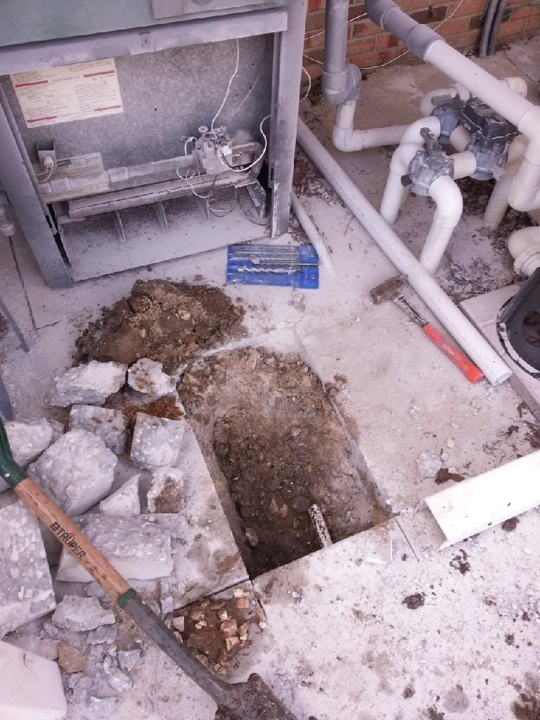

Pool equipment is depicted on the first picture.
