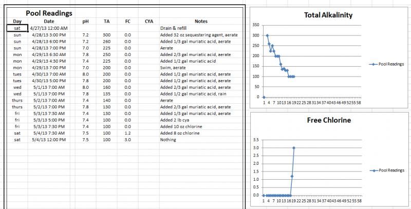

    Bosch232 is offline Registered+ Thread Analyst Bosch232 0
    Aug 2012
    Nebraska
    78
    Default Re: If this was your fill water, what would you do?
    Here is graphical data of my weeks activity.
    16x32 Oval AG vinyl pool; Media Master sand filter; 1.5 hp 1 speed pump; 10 hrs; Rural utility water; Taylor K-2006
