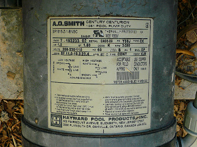

    Your photos . . .
    Equipment:
    Pool:

    You posted my pics, thanks so much!
    Now....go down to my timer pic...note anything a bit funny...? As I was adding more bleach today, I turned on my pump - and lo and behold, it appears my "OFF" slider on the timer came loose at some point and was sitting right next to ON. So basically, the pump has been turning ON at 12am, and turning off at about, oh, 12:05am. I know I know, genius.
    I dunno how long it's been like that, I can't believe my pool isn't 100% green! So, assuming perhaps this has been going on for a short while - do you think this is why my numbers could be odd (cya, specifically)?

    Nope, I overlooked that little timer problem, too. I'd recommend operating 24/7 for a couple of days, then testing when the K2006 arrives, and THEN deciding if something needs to be done.
