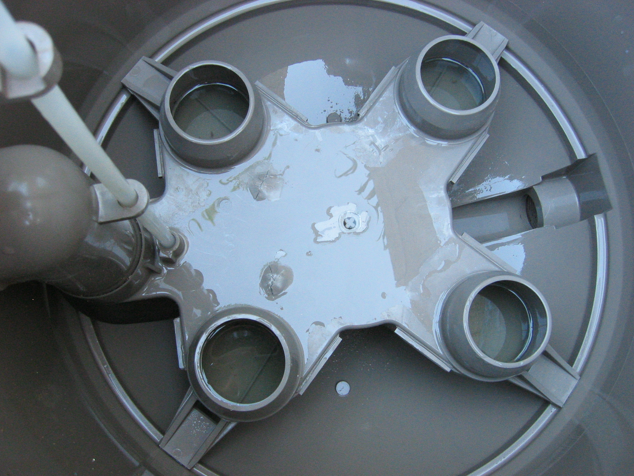

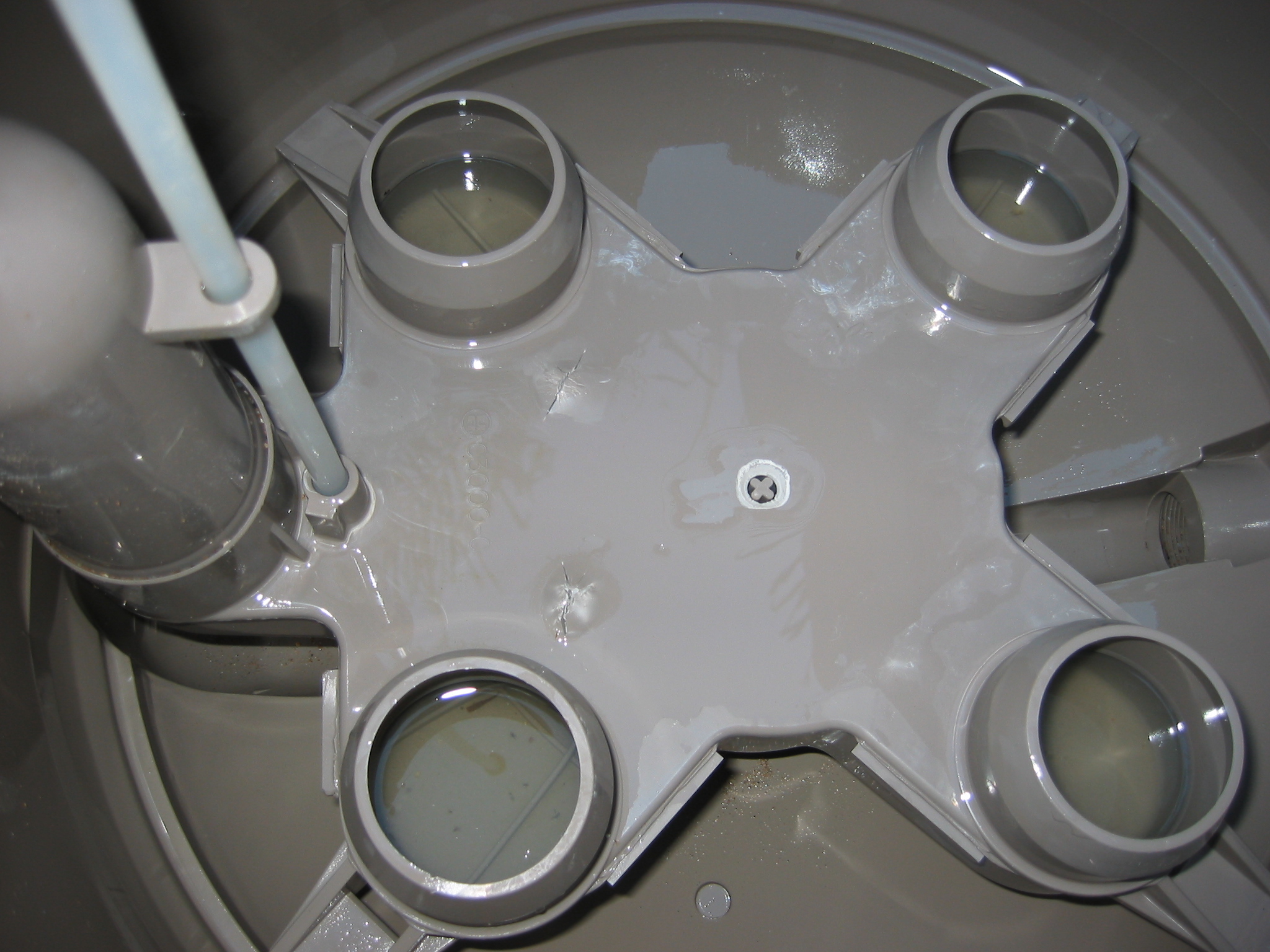

    I am having a major problem with my cartridge filter, it's a Hayward Swimclear 420sq. ft filter. After noticing last week that my pressure was running 32+ psi I thought my filters must have just been very dirty. After cleaning everything out I put the filters back in and started it all back up and it was back to 12 psi like normal and it was all working well. The problem was that after 30 minutes the filter was back up at 23 psi and after an hour it was stuck up at 32 psi again.
    After I saw this I turned the system off because it shouldn't be running that high of a pressure (this isn't an in-floor cleaning pool). After taking it all apart again I have seen that the "Bottom Collector Manifold" is cracked. The part # is 17 according to the diagram here: http://www.hydropool.com/cgi-bin/hyd...db/ml=100.html
    http://jeff.karau.com/pool_filter/IMG_2276.JPG
    http://jeff.karau.com/pool_filter/IMG_2278.JPG
    I have been having salt system and other pool system issues and I just wanna see if anyone else has seen a problem like this. Does the cracked manifold cause an increase in pressure like this?

    Let's start with the basics. How large is the pump in hp? How about the plumbing in I.D? How old are the cartridges?
    I have worked on these filters since the first 300sq. ft. models came out in the very early 90's. The manifold is the same in all of them. When ever there is 30 or more psi showing on the gage with nothing downstream ( a clog, non-booster pressure cleaner, etc.) to cause this pressure, the manifold will collapse as yours has done. Maybe not immediately, but it will happen.
    You do need a new manifold. Don't replace it until the cause of the problem is found. You probably need new cartridges as well as there are most likely small cracks in the end where it sits on the manifold.
    Since the manifold is cracked, your cartridges may not have been cleaned as often as they needed, your pump is too large, or both, are the best-guess candidate for what you see.
    If the bands that surround the cartridges are broken or the fabric seems "hairy" you need new cartridges. If the pump is anything over 1 hp it is too large and needs to be downsized. Just my opinion, but it has worked for the past 16 years.

    Default Re: Strange filter problem
    It is possible that the manifold is collapsing enough to restrict water flow, especially since the middle support is also uncovered at the top.
