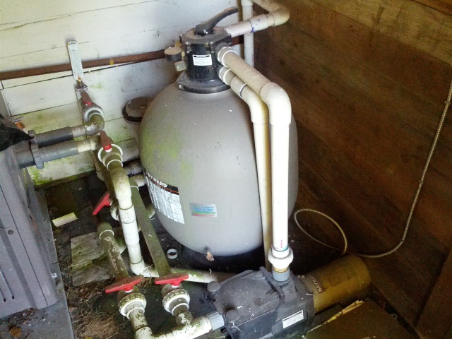

    There are others with much more knowledge than I regarding restoration that will be along shortly to offer advice, I think....but the thing that immediately comes to mind is the equipment--i.e. motor, pump,filter, etc. can you take pics of that and send them, also? Do you know if they work? Do you know the volume of the pool, or can you include measurements to help calculate it?

    Thanks for the responses. Here are some photos of the filter equipment:

    Thanks for the pics!
    We'll be here to help when you collect a few quotes.
