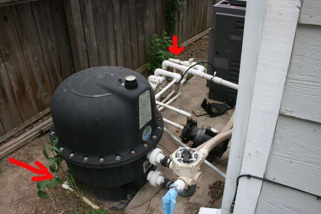

    So we closed on the house Friday and painted the inside over the weekend. I am now starting on the pool! Started cleaning it tonight, but ran into a snag. I was taking the leaves and twigs out with the leaf rake and noticed that the water was not draining from the rake and making it extremely heavy. I then noticed the problem, we have a cottonwood tree in the back yard which has deposited a ton of cotton on the bottom of the pool. About an hour or so into my cleaning my pole bent and snapped. Anyone have any suggestions for this? Can I get a stronger pole? Do I have to just watch how much I am picking up?
    Also, on a separate note, I started looking at my pipes, filter, and pump. I noticed that one of the pipes was cut through, this one goes under the concrete. I am assuming it goes to the skimmer or the drain. I will upload some pictures tomorrow and see if you guys can help me figure out what all these pipes are for and what I am missing.

    Hey guys. I think I am almost finished cleaning the leaves, twigs, and cotton out of the pool. Should I fill it after I am done with that or scrub the sides first? Also I have attached some pictures of the pipes and a picture of the pool so you can see how nasty it is . The red arrows point to the pipe that has been cut. If you could let me know what all the pipes are that would be awesome.

    Anyone make heads or tails of these pipes? I'm assuming the one that is cut is not an extra and that it will need replaced.

    I'm not sure of the plumbing but I'm guessing the cut pipes may have been for the heater which seems to have its ports capped and disconnected? Also, I'm wondering if there is another pump somewhere. I don't understand the skinny pipes in and out of the pump transitioning to what looks like 1.5" pipe. Almost like the pump shown was some kind of very low flow circulation pump and not the main pump.
    Anyone with more ideas?

    Yeah it is really nasty, tons and tons of algae. Thinking it might be worth the hassle to drain it at this point. I got to looking at the pipes and there should be another pump is what I am thinking as well. It is a foreclosure and they took all of the appliances so I am assuming they took the pump too if it was worth some money. If anyone else can help me with this mess it would be greatly appreciated.

    I think Al is right--the pipes to the pump look too thin, like maybe it's an automatic cleaner pump or a spa pump? I don't see an in-pump skimmer basket, which filter pumps always have, in my limited experience. Is that a pool heater or just the AC for the house?
    I'm thinking the best course is to identify where the pipes go (Drains and skimmers, backwash drain, returns), get a new filter pump sized to your sand filter, and re-plumb it to suit. It's all PVC, so it's pretty easy to work, but only if you know what to plumb.
    The skimmers and drains go to the pump, near its skimmer basket. It pumps water to the multivalve which can route it to filter and to the returns, backwards to backwash (and to the backwash drain), or directly to the pool, bypassing the filter.
