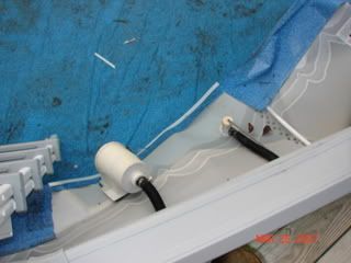

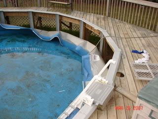

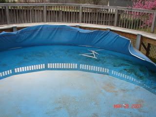

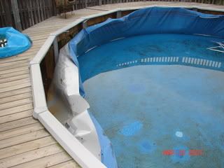

Now what!? Fixed the holes, pool collapsed!
:confused: Frustration doesn't even cut it at this point! The backstory is: We moved into a house last year with an ABG pool surrounded by a nice deck. SO happy. With the help of you guys, I figured out how not to get raped by the pool stores trying to get it clean and had much fun last summer. (Okay, after much trouble with our pump, but I think that's all good now.)
So this winter I pull a real dumby, don't do adequate research and emptied the pool thinking I was supposed to. A huge storm comes through, a piece of lawn furniture goes into the pool and puts three large holes in it. Again with your help, I found some boxer glue, got a box of vinyl samples from a nice gentleman at a different pool store and fixed it all up this weekend. Was quite proud of myself and ready to get things going again on the pool.
I started the water in it yesterday afternoon, got in it several times, the vinyl all looked fine, no excessive pulling, wrinkles, etc. It was nearly half full when we went to bed then a couple of hours later husband and I wake up thinking it was thundering. It's not. It's the sides of my pool collapsing. The metal and everything! in 3/4 of the pool, the whole side (with the vinyl still attached in most of the places) is bent over from where the water stops, up. Even the drain thing that leads to the pump is folded over with the wall. So now I have a deck with a large hole in the middle and a pool I have no idea what to do with.
I started to say 'help', but, wow, is there any?! Particularly with us being new(er) to the area, no family and not knowing that many people, all of these projects end up being a two-person job! (Like putting in hardwoods this weekend - ouch I'm so sore!)
What now guys?????

I feel so bad for you. Seeing your pics just made my stomach turn!! Good luck to you.

I am going to have to say that the liner shrunk and with filling it it pulled the sides in. It happened to me only I caught it as it was doing it on my first pool install here. All I had to do was let some liner loose and I was able to save it.
Re: Now what!? Fixed the holes, pool collapsed!
sevver
I figured that too.... looking at the way those walls collapsed, they were most certainly pulled down.

The thing is, the liner in the collapsed one shrunk and dried smaller.

Hey newbie, Since normally, once the water is a foot or so up the wall you are safe and out of any danger, before I go into a big long thing about what might have happened and how to fix it I have one question.
From your pics I did not see any signs of metal retaining rods. I enlarged them all and looked closely. Are they still under the top rail or does your pool not have them? They should have kept the wall from pulling out of the upright top plates.
Your photos have made a mess of my evening. I would give anything to have just one day where I could fly to your town and help you put this pool back together. I see pool disasters on a regular basis but not being there to help makes my heart bleed.
Start by locating the metal rods that hold the coping in place and we can go from there. It is all fixable, just not an easy thing.

seems to me liner shrank when pool was dry and empty. when refilled, water pressure from shrunken liner caused walls to collapse inward. liner must have been super tough not to break first though!

So sorry to see/hear what happened - definitely caused by the liner shrinking, however, I'm also surprised the liner didn't just rip appart.
if your walls aren't severly creased it could be relatively easy to get going again by installing a new liner - about 300.
First thing to do is cut the wall free from the liner and see what condition the wall is in, go from there. Any questions - post back.

I still can't believe the weight of the water did that damage. I had a hard time believing that the bent material was steel... it almost looks like cardboard.

So sorry it's taken this long to get back on the thread. Quite honestly, I was just so sick from what happened and afraid of how expensive the fix might be! We just used tax return for some other things needing done on the house before this happened so now we're stuck fixing this as economically as possible! (of course - who doesn't want to right?!)
The upright rails are still standing - the sides just pulled out of the top rails nearly entirely. The top rails are even still attached. We have been able to straighten up the walls - the creases aren't so severe that it damaged them I don't think. I believe when we get water into it, it will finish straightening them.
We want to try to get a new liner, because I agree - I think it shrunk up and pulled the sides down. We were looking at the beaded ones since they look to be easier to install correctly. Is that right? With just the two of us (and one teenage kid) it's going to be tough to put this thing back up (unless I can sprout a few more hands soon!)
I really appreciate the help and kind words. It really does make me sick that the pool has been such an expensive thing to learn how to manage, but I love it anyway. I was excited that I now knew how to care for it with regular bleach and such after spending so much at the pool store in the beginning last year, now this. Such is life, right!
OH, additionally, if anyone has advice on where to get a liner, type (beaded/overlap - gauge) and how do I make sure the cove is okay (that it's not washed away too much) I'd appreciate it. Right now we have a 24' x 48" overlap, sand bottom and cove.
