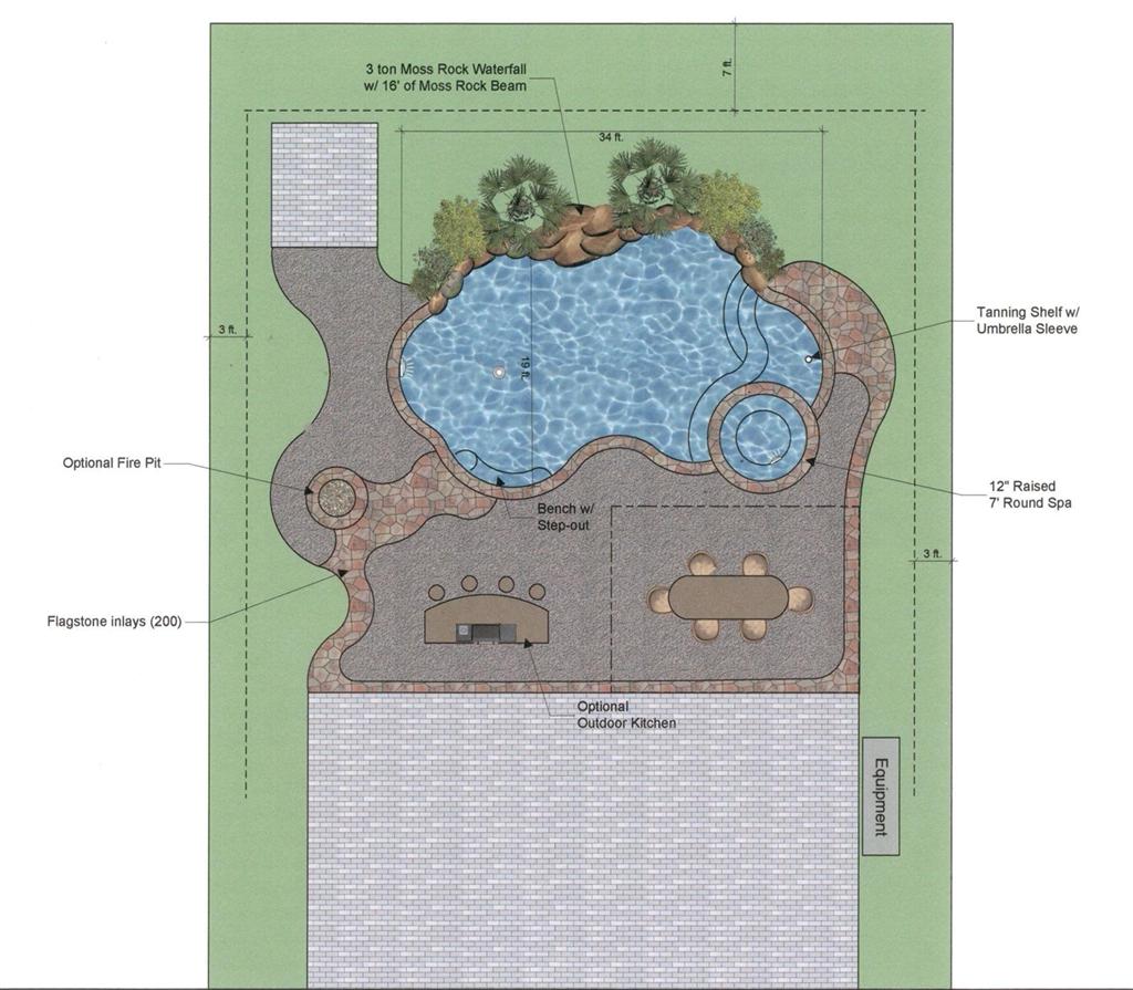

I am very close to pulling the trigger on a new pool and I am looking for some comments and/or suggestions. The pool builder is an established builder in NW Houston (The Pool Man). I am really looking for any and all suggestions to make to save me pain in the long run on my design or choices.
In this quote there are a few things that I am changing.
1. Change filter to DE
2. Remove infloor cleaning system.
3. Remove the Ozonator. I have read here they are not really worth the money.
3. Change from sundeck to peagravel (this was my wifes choice. She likes the look better. I know it is hotter then sundeck but I may have to go with the boss on this one)
4. Move the spa to the other side of the pool. I have a 2 year old and having it in front blocks my view. I am also having them enlarge the upper right side a bit to make the tanning ledge larger once the spa gets moved.
Here is a picture of the initial design
http://www.lanability.com/images/Image0011l.jpg

Steve I am also in Houston and currently reviewing pool bids. Your pool design looks great and is very similar to what we are looking at doing. Your pricing looks very competitive. So much so that I am probably going to call your builder for a quote.
Are you keeping the flagstone inlays with the pea gravel? We are also contemplating flagstone inlays in sundek. I hadnt thought about flagstone in pea gravel. That is a pretty significant cost savings switching to pea gravel.
You should also think about keeping the MDX drains and canister even without the infloor cleaning system. That way you can sweep leaves to the drain and have it go to the cannister. One of my potential builders will do that even without the PPC-2000.
Also you might consider switching the single 500w light to 2 300w lights to provide some better lighting. The cost difference should only be a couple hundred dollars

Seems like your equipment is a long way from the pool. Is that a bathroom/poolhouse in the upper left? That might be a better location for the pump/filter.
2HP pump seems excessive since the waterfall has its own pump.

Yes it would be pea gravel with flagstone inlay. I am not worried about the cost as much as the fact that my wife just does not love the way it looks. She grew up using a pea gravel pool and I think there is some nostalgia there. The problem is that was in NY and the deck gets a bit hotter here! They use the MDX drains even without the cleaning system. I don't think they keep the canister so I may add that. I forgot that I am going with 2 lights instead of the single. Thanks for the input and complements!
No that is a shed but I built it to look like a house. The equiptment is on that side becuase that is where the gas and electric are located. It is only about 30-40 feet from the spa. If I move it back by the shed it would be a fortune for the gas line and electric. It seems like the best location given the concerns. Thanks!

Make sure they don't butt the slab for the equipment against the foundation wall without an expansion joint or something to keep noise from being transmitted.
Make sure to go ahead and plan any fences or gates if required now so you'll notice any problems before you dig.
I highly recommend a poolhouse/cabana/changing room with a bathroom in the pool area. Traipsing through the house in wet clothes won't make mama happy, and you'll be going more than you think. At least plan for it if it's something you might ever want.

I will make sure they add an expansion joint between the equiptment pad and the house. I would love to have a pool house but my backyard is too small and the budget is just not there. Thanks!

A 2HP pump for a waterfall can be overkill and expensive. Then again if the waterfall is large and you want a lot of water then 2HP may be needed. When I did mine I installed a valve to route some water back to the pool. I also did a dual speed 2HP pump. This gives me the ability to run on low most of the time because it is cheaper and on high when I want a lot of water. On high I also can adjust the valve to get exactly the amount of water I want. Just some random thoughts.
Also did I miss the autofill? I would always do an autofill.

I am getting a 3 ton waterfall with about 1.5-2 tons of border rock that will have some weeping water. I will ask about how they valve it. As far as the autofill a lot of the builders do not want to do them because of problems. Have people here seen a lot of problems with autofills?

I would say get the autofill. Even if you just turn it on while you are on vacation it would be worth it. My .02
Re: Steve's pool project 1-24-07
I have a comment on the 2HP pump for the waterfall, I seriously doubt it needs to be that big. I have a 3/4HP pump on mine and it flows a lot of water. I can adjust the flow to the waterfall as it's got two outputs, one to the waterfall and one back to the pool. You can lower the waterfall output by diverting more water back to the pool. So far I can make it run like it's got a high flow stream by diverting half the flow back to the pool.
As for the autofill they installed one on my pool. The only danger I can see is that it has a valve on it that can be prone to cracking due to freezing temperatures. I have to put a towel over it if the temperature gets too low. It does have a bleed valve for this but a towel is quicker and more effective. You can turn the water source off to the autofill and then this way only fill it when you want to. The mechanism is very basic works like a toilet, just a float valve.
What I wish I would have done differently is watched the plumbing of the spa better. They didn't put any return lines to the spa so I have to run the jets to get the spillover.

I will have to ask about that larger pump. I am really on the fence with the autofill. It does not seem like that big of a hassle to turn the water on when needed. They do plumb a fill like but you have manually turn it on and off. I also though about hooking the fill line to an extra sprinkler actuator and run that zone from the pool control. I will have an extra zone now due to the pool taking up a good portion of the backyard. As far as the spa I am 99% sure they have separate returns so you don't have to run the jets. Thanks!

I know it seems small but I would consider 2 lights in your pool...we had our pool built this year and it is strikingly similar to your design. In the beginning our builder said one light was enough...just before they sprayed the gunite I changed it to 2 lights and in the end I was very glad that I did. I put both lights on a dimmer because the builder said it would be too bright but so far I have never touched the dimmer.
One other point that I saw someone else make was an auto filler/drain. I opted to not do this and it has been the largest pain with my pool. I also live in the Houston area and you know how much rain we have had lately...i have had to drain the pool several times in the last few weeks just to keep the water from overflowing...likewise last summer I was adding to the pool every other week. All it takes is one time to forget that you are dumping or adding water and the investment of an auto filler would have been paid for several times over.

I forgot to mention in my original change list that I am going with 2 lights instead of the single.
They are going to add an overflow so the pool will never overflow. I am still on the fence about the autofill. The PB I am using says the only one they trust is a digital one and it costs a lot of money. It seems like a lot of people here have not had problems but I have had a number of PB's tell me they are a lot of trouble. Thanks!

I am very happy with my autofill. It is a sump with a float in it, not digital, never had issues with it, 3 years now (other than the recent freeze in CA, but that was my fault).
The only problem was when I first got it running, plumber used alot of silicone on joints and they didn't flush anything and the filler valve was clogged with bits of silicone. No problems after I cleaned it out.
I also have autodrain. Both of these low-tech solutions IMHO are well worth the costs. I got these because I wanted to make my pool as low maintenance as possible.
You don't need anything digital for the autofill - autofill uses a float like your toilet, do u need a digital autofill for your toilet?

I talked with my builder and they said they have not problem installing one. They told me that they are not too happy about using them as they also do a lot of maintenance and find that they fix them a lot. I am very handy so if I have to fix a float every few years then no big deal. Thanks!

On your design I'll give you my .02
Ask for the credit on the Paramount Infloor cleaning system and take a Polaris 280 or a Pentair/Letro Legend with a booster pump. Take the credit and subtract the cost of the pool sweep (900 to 1000) Total credit 3300+-
Ask for the credit on the Ozonator (540)
Ask for the credit on Sundek (1815) and change to peagravel.
Apply this 5600 credit towards landscaping around the new pool.
I'd definitely leave the spa in its current location. On the right flank where it's located it won't block your view at all. It's positioned perfectly for minimal encroachment into the pool area and it allows gracious steps into the pool too.

Kelly,
First off, I appreciate the good things you have to say about The Pool Man. I did try to talk with you about giving me a quote. I left a voicemail and email but never got a response. I know you are very active here and have great insight into a lot of things.
I was planning on deleting the infloor and getting getting the Polaris 280 with the booster pump for no additonal cost. They will be using the Paramount drain and they are going to install the Paramount basket in the skimmer so I can sweep into the drain. I think it is a good comprise. What do you mean by the pool sweep?
I was also going to ditch the ozonator and Sundeck.
As far as the spa, I need to move it to the other side of the tanning ledge for two reasons. It is a 12" raised spa and I think it will block the view a little bit but the main reason is I am going to screen in my porch as I will not have enough space to walk between the spa and the screened patio. I could move the entire pool back but that is more decking, etc. I am going to enlarge the tanning ledge a bit so my 2 year old and soon to be 2nd girl have a nice place to play. Thanks for all the comments!

Here is an updated design. I am going to meet with them on Saturday to make some changes. I plan on moving the spa back a bit to increase the tanning ledge. We may have to change the lines on the back wall a bit. I am also going to increase the bench size in the deep end a bit.
http://www.lanability.com/images/Image001.jpg
Let me know what you think. Thanks!
That looks great! Now you dont have to walk around the spa to get to your main steps/tanning ledge. Good idea putting the umbrella sleeve in your tanning shelf. Are you going to do a 7ft or 8ft spa? I will be working on our design tonight.

It is spec'ed as a 7' but I am going to have them angle the walls back 4-6" so the spa will increase to about 7' 6". Thanks!

Love the design. Your pool layout looks very similar to what I built last year. We love the tanning ledge and the wrap-around bench around the spa. Feel free to take a look at my build previously posted. It should give you a since of what your shallow end will look like.
http://www.poolforum.com/pf2/showthread.php?t=5975
My only advise is to push the spa out of the pool as far as you can. It truly does take a lot of space from your pool. Good luck on your build and keep us posted.:) :)

Here is a picture of my final design. I enlarged the tanning ledge and added bubblers. I also changed to 2 lights and some other stuff. I also signed the contract so hopefully they will start in a few weeks. I will post updates and pictures as they become available. Thanks!

The new pool design looks great.
I didn't realize that screening the existing covered porch was something you were considering. The original design does not work at all with that in mind.
I'll give you a little insight to my thought on the new design.
Have the builder drop your waterfall flanks to weeping rock level and let the one on the right slip in slightly below the level of the spa coping.
I find that moss rocks placed over the top of a 12" raised spa like they have the drawing makes that particular rock and those adjacent to it look to top heavy.
just my .02

It shows like that on the layout but what the plan was is to have the spa spillway dump water on that rock and not the other way around. At the right side it is already a low weeping wall and the spa is raised 12" so the spillway will be above the rock. The spillway is going to be 6' long starting from the weeping wall. I think the program my PB used did not layer the rock under the spillway correctly. Thanks!

Steve,
Addition of the bubblers, a great idea. I have one on my ledge. However, make sure the plumbers plumb those things with enough spacing to where they will not cause a disruption in water feature. What I mean is, one will tend to be dominant over the other if they are too close together. It has nothing to do with water flow out of the pipes but the ripples in the water they create. One will tend to distort the effect of the other. I looked at 3 different pools from several builders with this existing problem. That is why I decided on one bubbler over two. Hope that makes sense.
Based on your updated plan, have you considered moving one of the pool lights into the deep end? I think you and I think alike. I did not want to see the lights (mounted in the pool) from where I am sitting by the pool or from inside the house. However, with your aggregate finish, you are going to need as much light spread through that pool as possible. Your light will be very muted towards the back. Just my 2 cents worth. Again, the design looks great. Keep us posted. :) :cool:

I never even thought that the bubbles would cause a problem. The ledge is about 8' long so I would guess the spacing will be 3-4 feet. Do you think that is enough to prevent the issue you are talking about?
This is my first pool so I am not sure how well lights work but I did want to have light without seeing them and that why we moved them to where they are. It would seem like there should be plenty of light as one points right in the deep end and the other towards the shallow. If I move one to the deep end it seems like the lighting would be more uneven. Should I ask the builder to make them both 500 Watt lights instead of 300 and install a dimmer? Thanks!

This is where you put yourself in the trick bag. The bubblers I looked at were probably spaced 24-36 inches apart. Without taking away from the look you are going for, I would say the wider the better.
As for lights, I am probably not the one to ask that question. There are several individuals in this forum that can better answer that question. I will tell you that my PB talked me out of spacing my lights too close and I am glad he did. I truly like how the light is dispersed in mine. Obviously, your PB is going to do what you ask him to do but hopefully he is also willing to offer his opinion as well. My advice to you is to ask him to take a look at pools he has constructed (same aggregate finish, lights, etc.) and go look at them in the day and at night. That should help you in your decision making process. Good Luck.
