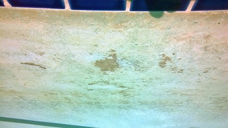

I am a complete newbie to the pool. I purchased a house recently and it came with an in ground pool. The pool was filled but contained some yellow.
I cleaned the pool and the levels back in check. Now I have one issue that remains. I have these stains on my walls and I have no idea what they are. I am hoping its not black algae
https://lh5.googleusercontent.com/-3...GX079ug-ed.jpg
http://i.imgur.com.KILLED/GX079ug.jpg
https://lh3.googleusercontent.com/-J...r1tSC2w-ed.jpg
http://i.imgur.com.KILLED/r1tSC2w.jpg
https://lh5.googleusercontent.com/-_...vE0jbFq-ed.jpg
http://i.imgur.com.KILLED/vE0jbFq.jpg
Re: Black algae or metal stain
I looked at your pictures -- let me show you the color enhanced versions, which often reveals more relevant info:
#1:
https://lh4.googleusercontent.com/-S...X079ug-ed2.jpg
#3:
https://lh5.googleusercontent.com/-V...E0jbFq-ed2.jpg
#1 looks like thin plaster that has worn through, and exposed the underlying concrete / gunite.
#2 is uncertain.
#3 looks like possible black algae.
Here's what you need to do:
1. Purchase a cheap local OTO / phenol red drops kit and test your pool
2. If your pH is above 8.0 or below 7.0, post here immediately, with pool dimensions, for further instructions.
3. If your chlorine is zero, begin dosing with 1/2 gallon of plains 8% store-brand bleach* per 10,000 gallons of pool water, added each evening (NOT: morning or midday!)
4. Order a K2006 kit -- see kit info link in my signature -- from Amazon ASAP; report FULL readings here, including CYA, calcium hardness & alkalinity.
5. Meanwhile, operate your pump & filter 24/7
* If you've added copper based algicides, cut that to 1/8 - 1/4 gallon each PM . . AND . . tell us what you added (brand / maker / quantity / pool size).

Thanks for getting back so quick. Those modified images do show a better picture.
Before you responded I did a ph test earlier and it was off the scale, added some muriatic acid to lower.
Once that gets circulated I will take another check. Then update my results.
I am ordering a test kit right now.
Thanks again.

Keep in mind, we haven't established that any of those spots ARE black algae. The most definitive test is to scrape some off with your fingernail, and smear it on a white card: black algae will smear dark green.
Brushing will make plaster wear through spots WORSE!
