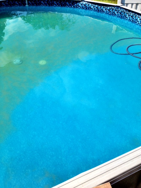

Extremely cloudy green water.
We're just getting our pool opened for the year and we had a lot of algae in the bottom of the pool. We used Aquachem and it's showing all levels are correct but the water is still pretty green and cloudy. (Link to picture below) It's a 24 foot round pool, roughly 13,000 gallons, our pH is at 7.6, FC is 1.5 and the test strips said this was all ok. We've used 3 lbs of powdered shock.

Ok, we vacuumed yesterday without the drop n' vac, then we put the drop n vac in last night and vacuumed again today. Definitely making progress. There's a ton of algae being washed out. We're doing the same thing again today. We brushed the sides really well while the pump ran after putting the drop n vac in. We haven't re-tested anything but chlorine levels yet, but we'll do that after vacuuming again tomorrow. As of today our FC is 10.5, CC .5, and TC is 11. So it's dropped a lot in the last week or so. (from a TC level of 26) Here's the latest picture.
http://f.cl.ly.KILLED/items/0m3r3G1F...3x/photo-1.JPG
https://lh3.googleusercontent.com/-m...40/photo-3.JPG
We can actually see the bottom now, but it's still pretty cloudy. I'm guessing the CYA is still high, so we'll test tomorrow after we vacuum and drain a bit more. Anything else i'm missing or are we on the right track now? Thanks a bunch for all the help. I'd still have a green, nasty pool without all of your help. :)

Thanks everybody. The algae is gone! We've tested, and we're ready to fill up. Just want to double check a few things and see what needs added. Vacuuming to waste got rid of about 1 - 1.5 feet of water, and here are our latest results.

Looks like we are good. All levels are where they need to be. Can't thank you guys enough. Last question. (I think, lol) When we close the pool at the end of the year, what exactly do we need to do? Just trying to get this implanted in my head now so i don't feel lost in September/October.

Wow! What a change? The pool looks great!
