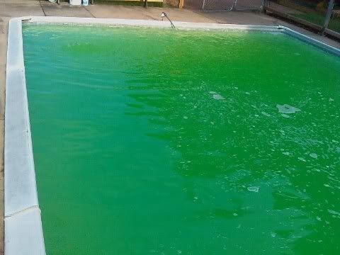

The pool is no longer green - it is only cloudy now.
Here is the pool when it was green: http://www.flickr.com/photos/3521519...in/photostream
Here it is last Saturday when it finally turned blue: http://www.flickr.com/photos/3521519...n/photostream/
Here is a close-up to show the unchanged poor visibility: http://www.flickr.com/photos/3521519...n/photostream/

Re: Time to replace sand?
Here is a photo of my pool taken this morning. This is the BEFORE photo.
I've spent the past two weeks working to eliminate the excess ammonia and lower the TA - this was not a process where progress is visible.
Now that Ben has increased the evening dosage of bleach to shock levels (considering my high CYA), there should be some visible progress as the algae and visibility problems resolve.
I'll post an AFTER photo as soon as everything is balanced and clear. This is day 33 since opening the pool - wish I'd never gone to the pool store...

This morning the FC was much higher than in the past and I think it may be affecting the TA test. Today the TA test water turned from green to briefly bluish to pinkish. All other days the TA test water has changed from green to briefly purple to a deeper red.
The pool water has a little more visibility (almost 30") and the shade of green is lighter so the shock is attacking the algae and POPP seems to be paying off.
The recycle man has dozens of bleach bottles to pick up this morning, but my 5 gal. carboys arrived last night and today I'm making my first run to fill them with 5 gal of 12.5% bleach.- Given that my CYA is between 100-200, can anyone give me a ballpark estimate of how much bleach I'll be using each week to keep my chlorine in the 8-15 target zone (once my water is balanced and clear)?
I'm using a 9 gallons/day dosage now until the FC holds within 1 ppm from one evening to the next (once I switch over to 12.5% bleach, the 9 gallons will convert to just under 4.5 gal).
