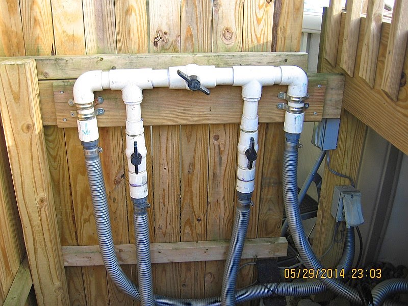

I have a 4'x20' solar panel on my 27ft AG pool. We built a south-facing rack to mount the panel on. I can either run all, none or part of the flow through those panels. The plumbing is basically some flexible hoses, a few pvc ball valves and some pvc. I will take a picture and post it in a while to show you my set up. The solar panel, combined with the solar cover, make a huge difference in the temperature of my water.

Wow, this is some set up PoolDoc. Do you have the pvc running under ground? Also, the chicken wire, is that to keep little critters from chewing on it? That looks totally foreign to me, where do all those hoses go to?

Those are actually my pics and he just posted them for me. The third picture that I just went back and added explains the reason for the chicken wire! ;) It had to be added to keep my two youngest golden retrievers from using the solar panel as a lounging area! They are scared of thunder and fireworks and anytime they hear either, for some reason they want to get on top of things!
The pvc is running underground. The inlet from the filter is the hose you can see on the right side of the pic which is fed from underground pipe. The outlet is the one you see on the left which takes the warmed water back to the pool. The valves are posted on a privacy fence that is around the pump and filter to hide it from view. Hope it makes sense. (I used to just have hoses laying on the ground leading to and from the solar panel but didn't like the messy look so buried them.)

You certainly don't have to have a solar planel plumbed with as much work as we did on ours. You can simply have a flat place to lay it out and hook up a hose from the filter to the inlet of the panel and another hose from the outlet of the panel back to the pool return and you are in business. The valves are there so that it makes it easy to divert the flow to the panel or to turn the solar panel off in the evening or whenever it is cloudy or rainy, etc.
