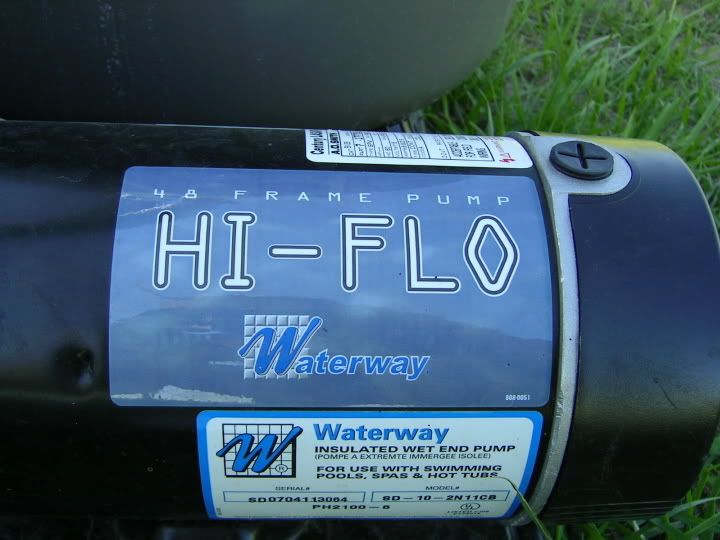

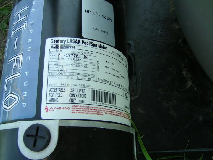

Next time you look at your pump can you tell me how many amps it uses on low and high? I;d appreciate it.
Re: PH question
Re: PH question
Thanks Hoffmans, that is exactly what I need to upgrade to. I appreciate the pictures too.
