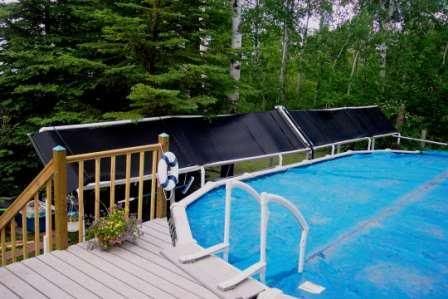

Anyone have any pictures of their Solar Panels?
I'm sooo close to buying a solar heater, but the only thing stopping me is placement of the panels. I'm scared of the roof because I've been reading that if it malfunctions, you could damage your roof. And I don't have the lawn to spare to just lay it on the ground
So, now I've gotta find a new location that won't be such an eyesore on a lot that is only a 1/4 acre with a pool and a house on it. It could look very industrialous if not done with care. My latest idea was to basically build something similar to a canopy. 4 posts and a roof. Put that pool side with the panels on top. Won't help the neighbors views though, so I'm hesitant.
Anyone have any pictures of their panels they could post? Or have some good ideas I'm not thinking of? I even thought of building a cabana and putting it on that, but a 20 foot cabana is a bit monstrous for my layout
Thanks!

Go to Above Ground Pool Gallery, post # 20 for mine. The decking is the solar system. Keeps the water warm and your feet from burning!

Thanks for the great pics everyone! It's giving me some good ideas.
Oh and CarlD...nice job on the floor unit being your panels...Impressive!

Thanks! My better half was very particular about how our pool would look, and this was a great way to incorporate what I wanted, what she would find attractive, and what the town would let me do.
