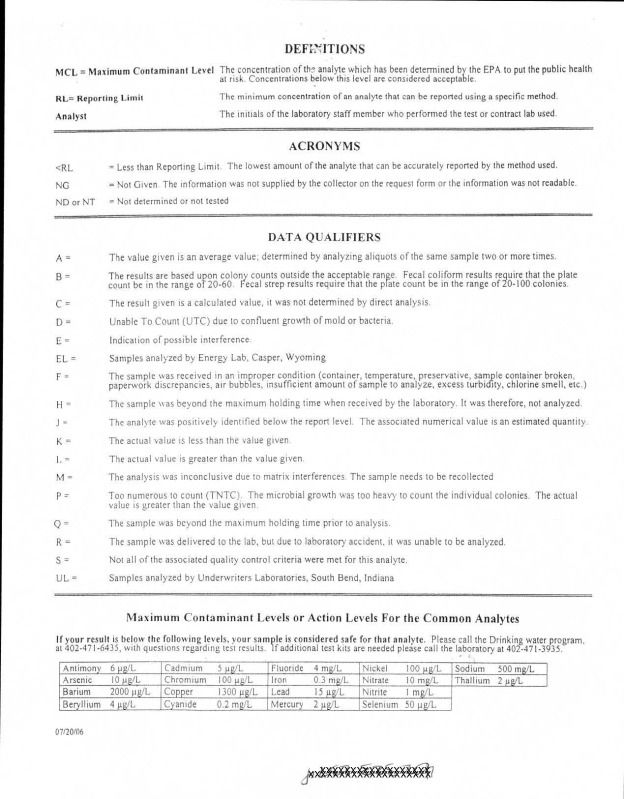

I just found our water company's newsletter.
Please look at the bottom of the fourth page.
Is that info helpful?
http://lrwd1.com/Newsletter.10.pdf
(edit) I just noticed it's a newsletter from 2009. Things may change over time, so I'll find more current info. But based upon that report, what do you think I should do first?
Re: My first step in getting off $oft $wim...
I've asked Ben to check into this thread and see if he has any specific advice for you, given the water quality report. It would be helpful to know what causes the brown--if it's metals, tannins, or just water source, because that's going to determine how the cleanup will go. Let's see what Ben has to say, and then you can get a plan together from there.
