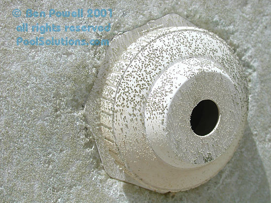

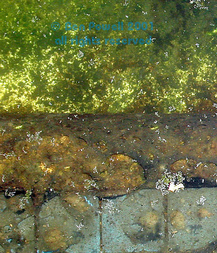

7. See if what you have is residue from 'sand algae':
https://lh6.googleusercontent.com/-d...gae_09_HHH.jpg -- https://lh6.googleusercontent.com/-J...MG_2545-ed.jpg
Before clean up: https://lh6.googleusercontent.com/-d...gae_01_HHH.jpg
