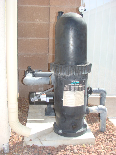

If you could, go ahead and take pictures of your pool, and your equipment, and send them to me (poolforum@gmail.com) for a reference post.

I sent photos of my pool and equipment to the address you listed.
