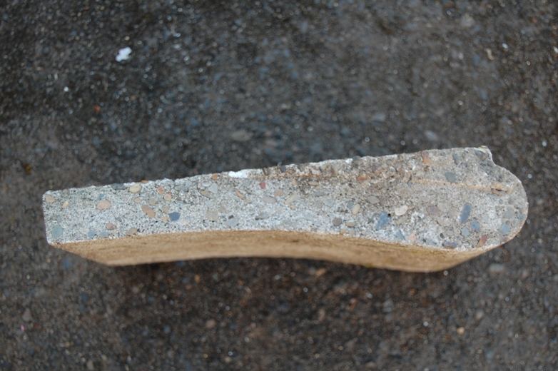

Our in ground pool was installed July 1960. Several of the concrete coping stones are broken and we'd like to replace them or install new coping. Anyone know of a source?
I have a couple of photos but will need to figure out how to add them.

But, I'm doing so now as part of a cleanup process, because they are good examples of old cast concrete coping. I've dealt with these many times locally, and always found the problem to be that they were locally cast, using local molds, that were no longer available. This leaves four options that I know of, when they need to be repaired or replaced:
1. Use a high strength concrete patch to 'glue' them back together, when they break. I've done this with cement and Acryl-60 latex.
2. Pay the local company to make NEW molds and recast the coping. This is very expensive, so I've never followed through.
3. Find locally available coping that matches as closely as possible. I've wasted a lot of time on this, and ended up with coping that didn't match all that well.
4. Remove all the coping, and pour a new cantilever edge.
